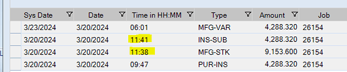

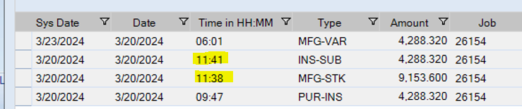

Below the sub was added to the job 3 minutes after the MFG-STK receipt was done, so the sub was a variance. Correct processing in order is important to costing.
