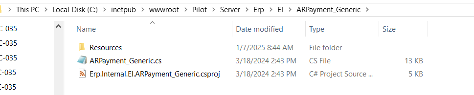

I create a new dummy appserver and find the default sources and .csproj files in the server folder, but I’m not sure if there’s equivalent for cloud.

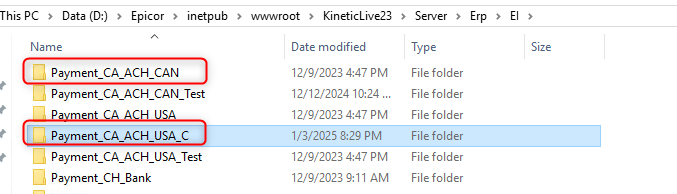

This is an on-site installation, not cloud. I created a new electronic interface “Payment_CA_ACH_USA_C” that was a modification of “payment_CA_ACH_CAN”.

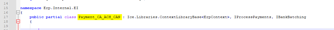

The first time I used “Payment_CA_ACH_USA_C” I forgot to change the class name, it was the same as “Payment_CA_ACH_CAN”.
So, when I ran this it changed “Payment_CA_ACH_CAN” to the new updated code in “Payment_CA_ACH_USA_C”. My question is where does Epicor create the compiled “Payment_CA_ACH_CAN” class?
I have corrected the problem by changing the class name in “Payment_CA_ACH_USA_C”, so it is now it’s own class. But, “Payment_CA_ACH_CAN” remained broken until I made a change to “Payment_CA_ACH_CAN.cs” (I added some blank lines), forcing it to re-compile. Now, all three electronic interfaces are working correctly and independently.
Again, where does Epicor store the compiled class files? I am thinking I could have just deleted the bad file, forcing Epicor to go back and recompile the code in \Server\Erp\EI
