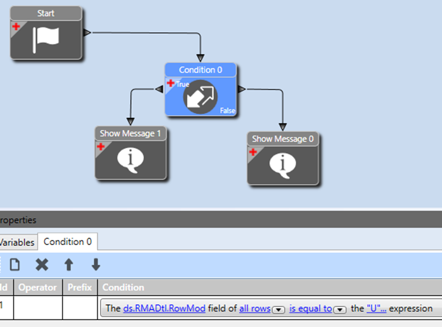

For now, I am just experimenting with showing messages.

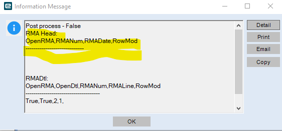

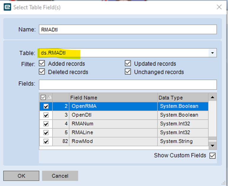

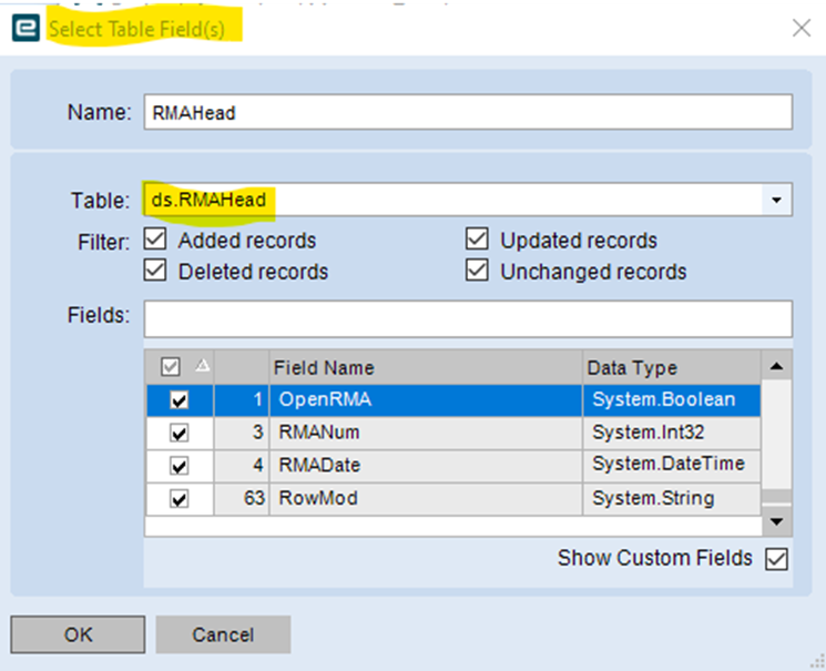

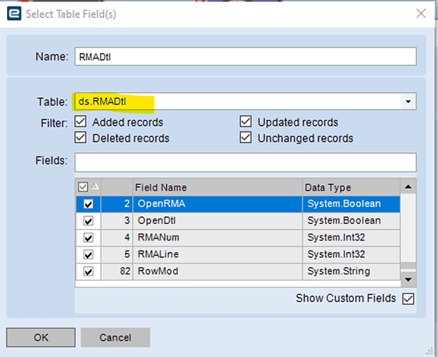

I created two table queries one for RMAHead and another for RMADtl.
The message is showing the following:
i hope the screenshots are showing OK.
