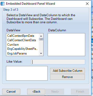

Hello,
I haven't done this in a while and I wanted to make sure that I'm not missing anything.
I have created and deployed a dashboard assembly that I want to add to project entry using the Sheets Wizard in the UI Customization Editor.
The dashboard will subscribe to Project ID so that it's data is limited to just data relevant to the current project.
I followed the sheets wizard and everything seemed to go fine. I did notice that there didn't seem to be a direct link between Project.ProjectID and a field in the dashboard but I'm assuming it will find it because there is a ProjectID field included in the dashboard.
When I click the retrieve button on the embedded dashboard, the underlying BAQ seems to run forever. I eventually killed the app server process running my the test server to free up the Epicor client.
I thought that maybe there was something wrong with the BAQ but when I add a criteria to limit it to one Project ID, it runs within a reasonable amount of time.
I'm wondering if I'm missing something on my dashboard setup. I just created a new dashboard, added the BAQ and then deployed it. I made no other changes to the dashboard.
Is there something else I need to setup on my dashboard to get it to worked?

When you embed the dashboard you should have to tell the dashboard to subscribe to the UI data, you can pick how you want to do it. I typically include the retrieve button so a user has to active it and it's not just running and causing performance issues.
After you tell it to subscribe then it should take you to a screen like this where you can pick the field that you need to subscribe to :
hope this helps!
-Bobby

No errors. I underlying BAQ just runs for a long time. If it does finally finish, it's returning unfiltered results.
I'm playing with adding a filter to the dashboard with ProjectID = Dashboard Browse. It looks like I also have to mark the Dashboard Browse as primary. This seems to be working except that the dashboard is refreshing automatically even though I've included the Retrieve button.

You must add a Dashboard Browse assigned to the ProjectID field so that the embedded dashboard will subscribe to the UI data.
