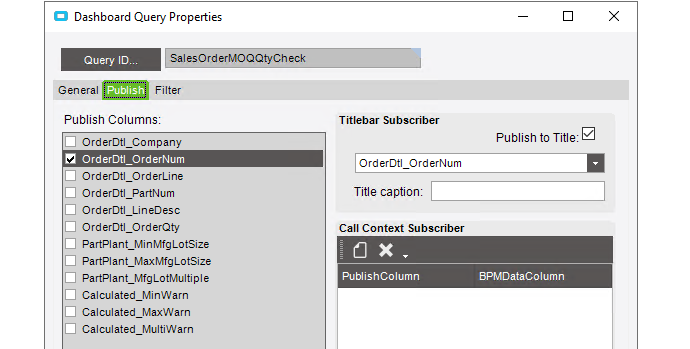

I have an embedded dashboard in Sales Order screen that displays some line information along with extra data, it subscribes to ‘OrderNum’, when I open the sales order screen it populates fine, however, on editing or adding lines it doesn’t refresh.

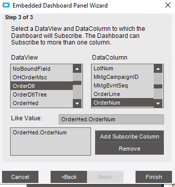

You’ll need to subscribe at the line level, not the header.
Hi Kevin,
This is the setup.

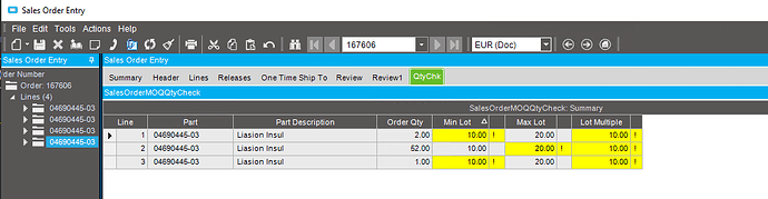

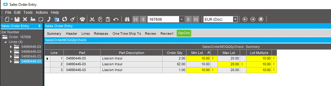

However, if you see the sales order screen there are 4 lines on the sales order but only 3 showing in the embedded dashboard.
I have now tried to use a BAQDataview instead, I have the Dataview working and using the ordernumber to filter the BAQ results, however, the dataview does not refresh - same issue as dashboard.
