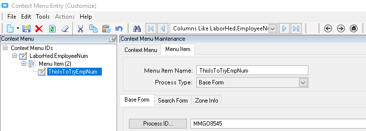

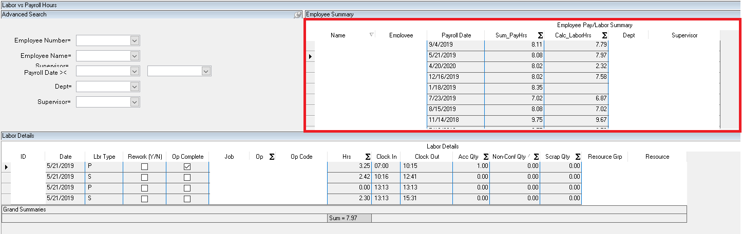

I am working on customizing a dashboard called Employee Labor Balance. I need to add a right-click open with option for Time and Expense to the right side of the dashboard below.
The right-click open with needs to work on JobHed.EmployeeNum. I have added a Context Menu entry for it and tied it to the process ID of Time and Expense.
However, when I right-click on EmployeeNum I get no open with option. Any ideas on what I can do in order to get
Is the Employee column in the Employee Pay/Labor Summary grid straight from a table or a calc field?
Go into the BAQ that generates that data and check to see if that column was added in the BAQ Search tab as a BAQ Like Column
@ckrusen,
The employee column comes from LaborHed.EmployeeNum. Additionally, that column was added to the like column.
I thought the issue was with the BAQ and/or dashboard.
But it’s more likely that you won’t be able to use Open With, the way you want. “Open With…” is intended to open a particular record with the key field in focus.
But in Time and Exp, the EmployeeID doesn’t refer to a specific record to load.
That exactly what I’m trying to do. I’m trying to open time and expense with a specific employee ID. Thanks for the help Calvin!

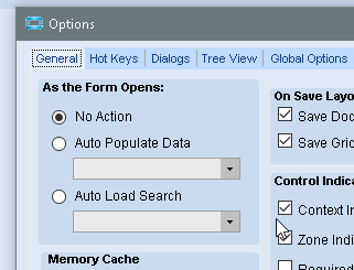

Hey just added empID to the table in question and it can right-click open with Time and Expense Entry just fine. Now the problem is that it is not populating the empID into the Time and Expense Entry Form. I believe this has to do with TIme and Expense automatically populating the empID based on the current user, and when you right-click open with it sends an additional empID thus causing the form to bounce all credentials. How do we turn off the auto-populate procedure for Time and Expense Entry?
Check the “As Form Opens:” setting on the Options for that form:
Set it to “No Action”
@ckrusen,
That got it to stop populating in the current user. Now the problem is that the Open with function does not seem to be passing the empID on the the T&E Entry screen. It just leaves it blank. Does this have to do with call context or a bpm of sorts, or did I miss a step on setting up my open with?

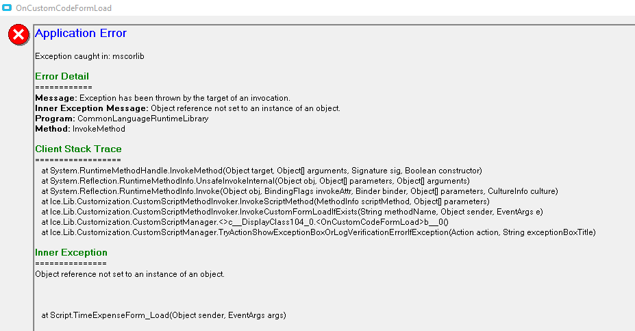

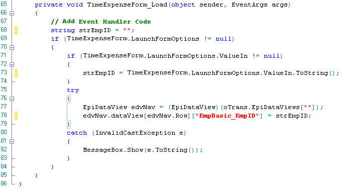

Currently trying to follow this train of thought. I have a custom code set up on the Time and Expense Entry form:

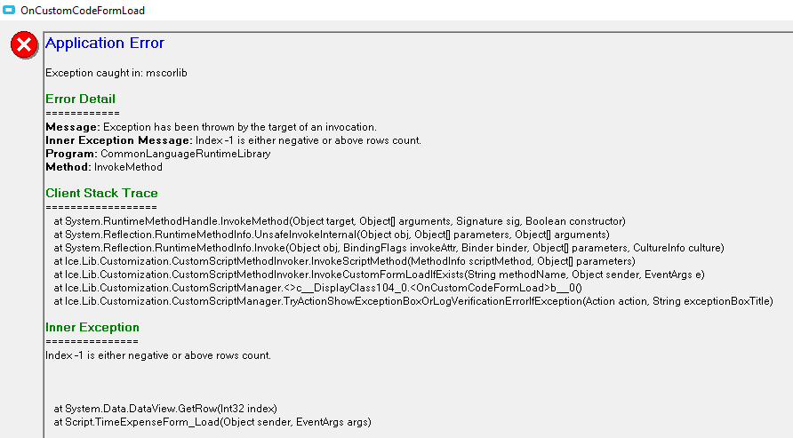

But I’m getting the following error when I right click and open with on the Dashboard:
I’m not sure if it has to do with line 77 not having an entry for “(oTrans.EpiDataViews[”“]);”.I’m not really sure what would be there to begin with.
Did you at least try putting a
MessageBox.Show("strEmpID: " + strEmpID);
after strEmpID = TimeExpenseForm.LaunchFormOptions.ValueIn.ToString();
to make sure that’s even coming in as expected.
edit
after another look, it looks like there isn’t the a “record” to be setting with the strEmpID. You may need to make a new blank record first, and then set it with th strEmpID

We set strEmpID to blank right after the comment text and assign it to the in value passed from the dashboard in the second if.
I’ll also be completely honest I forgot to add a trouble shooting message to the code, so good catch there! Got the following result on code run:

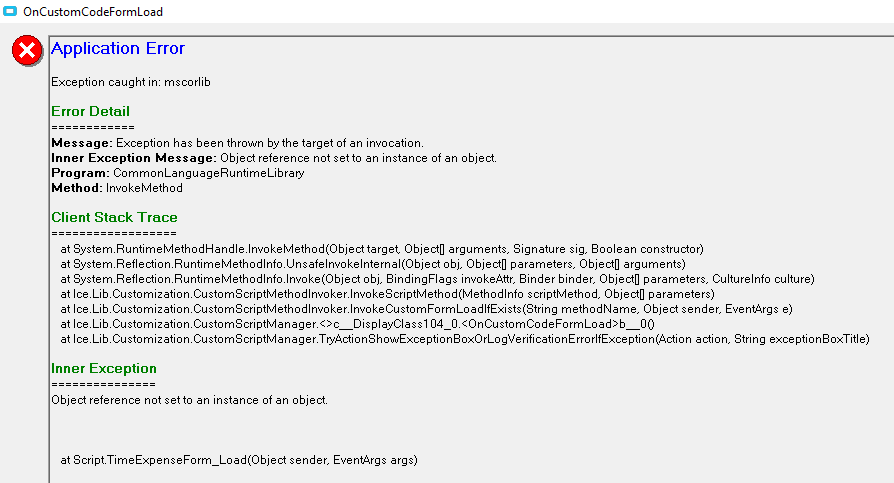

And the following error:
It’s not my specialty … but I think you need to specify the object to make a the dataview for.
EpiDataView edvQuoteDtl = (EpiDataView)(oTrans.EpiDataViews["QuoteDtl"]);
See how that specifies "QuoteDtl"?

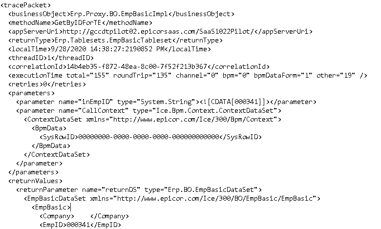

You probably want to run the T&E form manually, with tracing enabled to see what it is using.
@ckrusen,
Got done tracing it. Which part of this am I looking to use?
Just a guess, but try EmpBasic

Just got done trying it. Error Changed:
what is Index -1?
Index -1 is probably the index of an array of records. Typically, arrays are referenced by their index with it going from 0 to NumOfElements-1. An array with 10 elements would be a[0] for the 1st, a[1] for the 2nd, … , a[9] for the 10th.
I take that error to usually mean that the array is empty - I.E. no dataset yet.

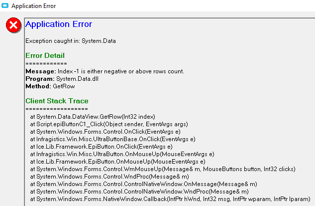

Try the following in a customized T&E Form
  1. Add a Button
  2. Add a click event for that button
  3. add the following code to the click event.
EpiDataView edvNav = (EpiDataView) (otrans.EpiDataviews["EmpBasic"]);
edvNav.dataView[edvNav.Row]["EmpID"] = "000412";
Save and launch that customization.
Clicking the button will probably give you the same error (unless changing "EmpBasic_EmpID" to "EmpID" fixed it).
If it errors out close and relaunch the form. Now before clicking the button, use New on the menubar to make a blank record. Then try clicking the button. If it works, then you know that the blank temp record must be created first.
@ckrusen,
We get this error when we use the button.
If I enter an empid then the button overrides it. If I clear the form and click the button we get the same error. I cannot create a new record without having an empid in first
