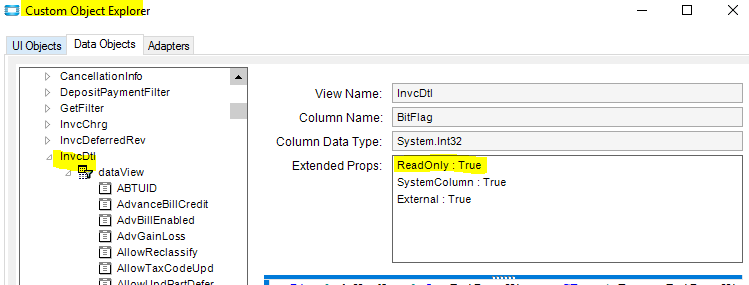

If you use Tools>Object Explorer in customization. Then click data objects you see all of the dataviews. In this snippet (mostly unrelated) you can see the field I am looking at is readonly. You can use the customization wizard to fix that I believe.

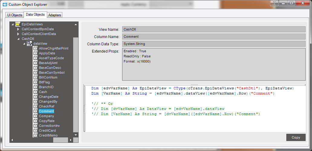

I followed what you showed me and this is what it has.
