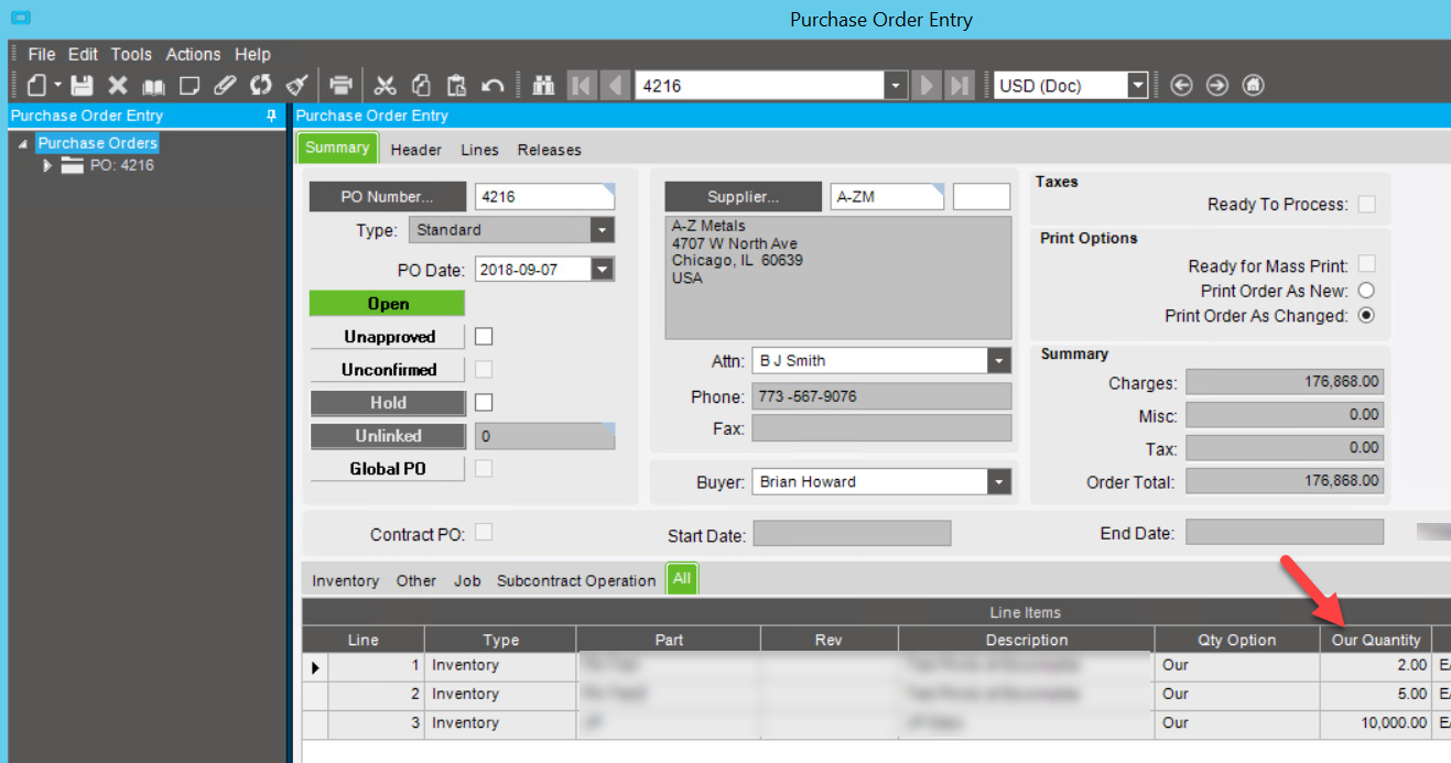

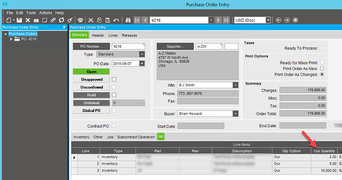

I’m trying to make editable the Our Quantity column in the All tab in Purchase Order, by standard the POAllLines view is disabled I tried using the extended properties to enable it but it didn’t work. Does anybody know a way to make either the view or the column editable?
As I understand it, it is the Qty Option that drives the Our Qty field. can yo try and change from “Our” to “Supplier”

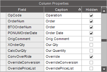

I have noticed when you do a personalization there are two fields XOrderQty with a of Caption Our Qty and CalcOurQty with a caption of Caption Our Quantity. I am wondering if one the CalcOurQty field is hidden. In our system you can edit it if the Qty Option is set to Our Qty, but not the XOrderQty field.
If i had to guess, that’s probably not the actual qty field, but the display version of, which gets calculated. Have a look at the field name and verify it is what you think it is.
Edit - I see this is the case in the screenshot above.
