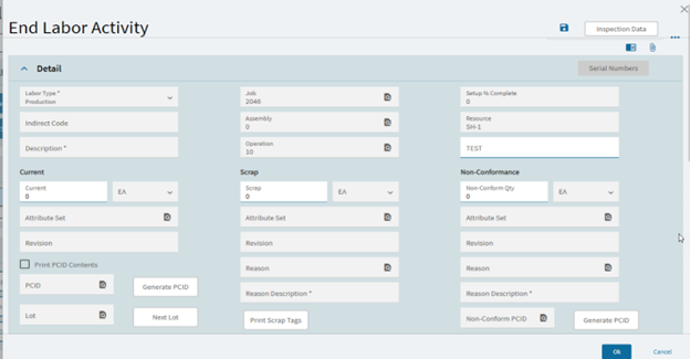

I’m trying to use a scale via USB to send qty when ending activity. The scale is just sending a number based on weight. When a user clicks the Current field it highlights to 0 in that field but when the data is sent from the scale it doesn’t clear the zero but instead keeps the 0 at the end of the number.

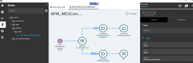

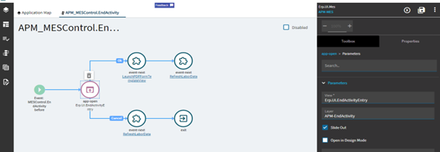

I’ve created an MES customization layer and added an event before MESControl.EndActivity. This all works fine as I see my customization layers.
I added a text field for a sanity check as I am unable to Auto Focus on the Current (LaborDtl.LaborQty) field. I can set Auto Focus on the text field and it works unless I bind it to the LaborDtl.LaborQty Field.
Once I bind it, it reacts the same as the Current field and won’t Auto Focus. The end goal is land on that field and clear it…but alas my efforts have failed.
