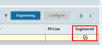

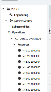

On the Quote side, we have engineered the part and checked the ‘engineered’ box. The revision for this part is properly approved:

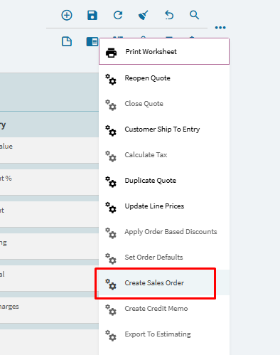

Then, we use ‘Create Sales Order’:

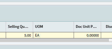

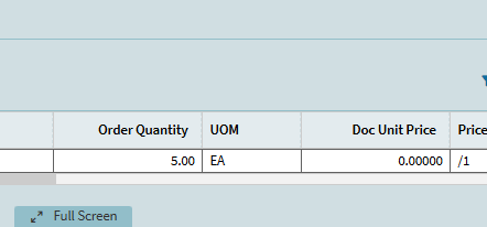

Also, our price does not seem to carry over when using the quote order wizard:
On the quote:
On the actual created sales order - our quantity came across but not price:
Using ‘Create Jobs’ on the sales order creates our job with zero materials and zero operations - where did these go? Our quantity seems to be the only remaining proper value.
Job status:
Job completely empty:
What are we missing here? How can we take a part that is engineered in the quote and carry all of that through to the order, job creation, etc? This part is type Manufactured

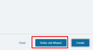

Ended up figuring it out - I wasn’t creating the sales order correctly from the quote.
Instead of simply hitting the ‘Create’, we have to go through the job wizard screen. This properly pulls our engineered job from the quote. This is still within “Create Sales Order”:

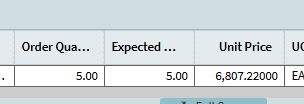

Then, since pricing wasn’t carrying over to the order since we didn’t use any configuration rules etc - I created a function on the order entry side that fires if it finds the specific part that we are creating this functionality for. I probably could have done this slightly better but here is the code:
string companyID = "*****"; //redacted for privacy :)
PartFound = false;
FoundPrice = 0m;
foundOrderLine = 0;
// Try to find a line with partnum = "5865000"
var orderLine = Db.OrderDtl
    .FirstOrDefault(d => d.Company == companyID &&
                         d.OrderNum == SalesOrderNum &&
                         d.PartNum == "5865000");
if (orderLine != null)
    PartFound = true;
  foundOrderLine = orderLine.OrderLine;
    // Only continue if we have a valid QuoteNum
    if (orderLine.QuoteNum != 0)
        var quoteLine = Db.QuoteDtl
            .FirstOrDefault(qd => qd.Company == companyID &&
                                  qd.QuoteNum == orderLine.QuoteNum &&
                                  qd.QuoteLine == orderLine.QuoteLine);
        if (quoteLine != null)
            FoundPrice = quoteLine.DocExpUnitPrice;
After retrieving the price, I simply update the price within the order entry application based on our FoundPrice response param.
