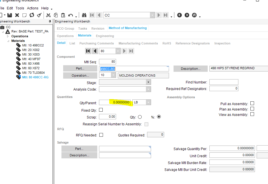

I thought you could enter a quantity as 0 in E10. I want to add material as reference…was this removed?

When I tried we were on 10.1.600.5 and now on .12

It is because we had pull as assembly, noticed that it was not checked in the image above.
