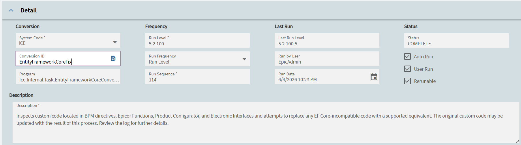

Entity core framework fix at 2026.100?
Anybody seeing this after the conversion last night?
In this system it doesn’t look like anything got changed but the conversion description is concerning. After the dumpster fire last year, I thought Epicor had said they would only flag and not modify custom code during conversion? :dumpster_fire: Unacceptable. Epicor, do not touch my code
I do see there is at least a help article filed about it, confusingly, under 2026.1 (didn’t we just get upgraded to 2026.100?).
I remember talking about EF Core in another thread. But I can’t find it now.
To eventually move off SQL Server ( :safe_harbor:) they have to get onto EF Core. It’s the future of Entity Framework. EF 6 goes end of life soon. Microsoft has stopped all development of Entity Framework and is only now working on EF Core.
Right, that is explained in the help article. I just don’t understand why they would modify rather than flag existing custom code.
I’m guessing because they want to move quicker than that. And just flagging it won’t get most peoples attention. People will just ignore the warnings and let it go.

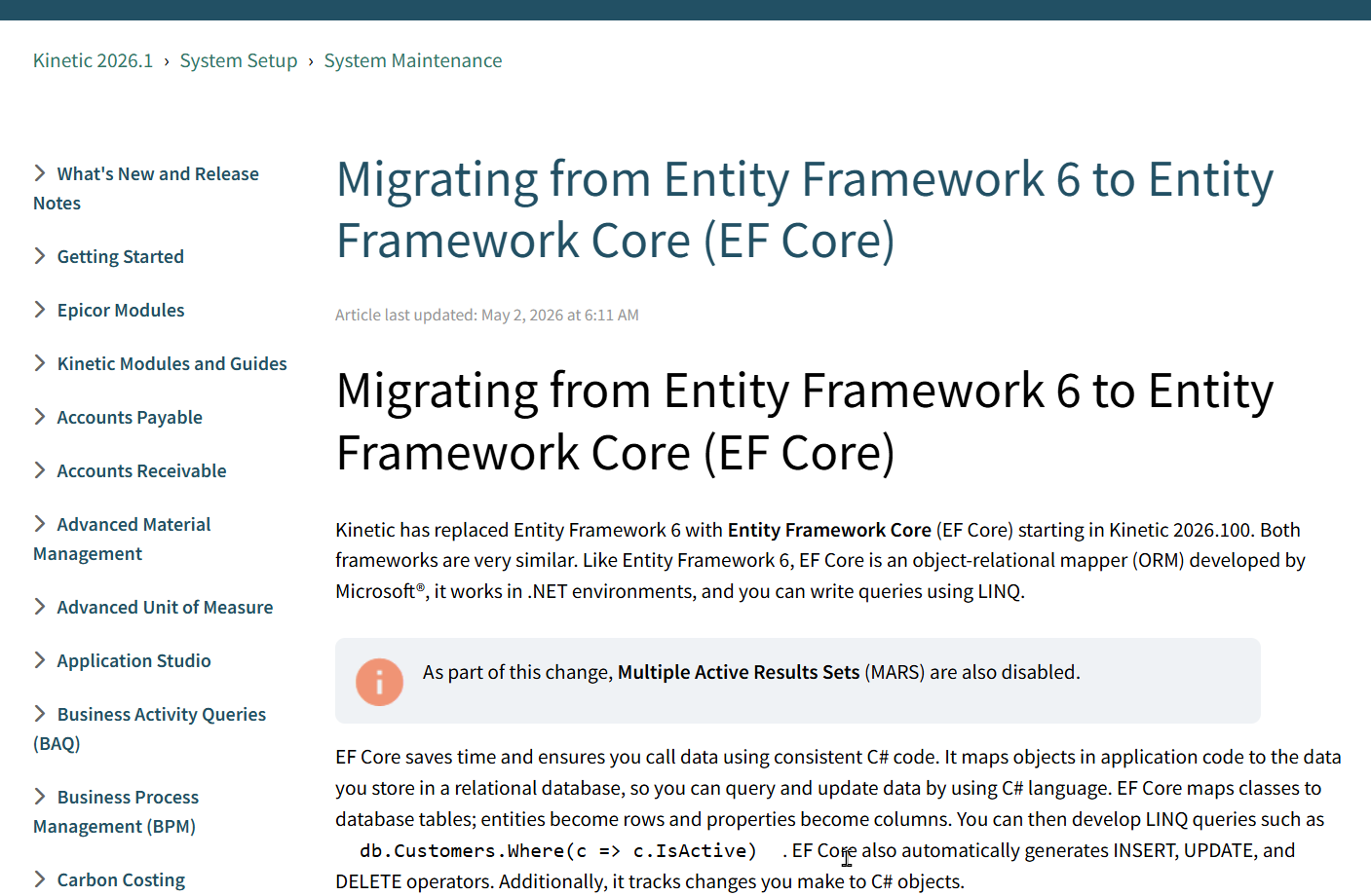

Migrating from Entity Framework 6 to Entity Framework Core
Entity Framework Core (EF Core) is stricter than Entity Framework 6 (EF 6).
To help identify potential issues, we’ve added several code analyzers that run when you save your BPM or Epicor Function (EF).
To assist with addressing these issues, we have added a Conversion Workbench task called EntityFrameworkCoreFix number 114, which during migration auto-fixes or provides additional diagnostics for many (but not all) compatibility issues across BPMs, Epicor Functions, Electronic Interfaces and Product Configurator.
You may see warnings related to the following issues.
