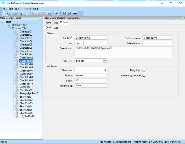

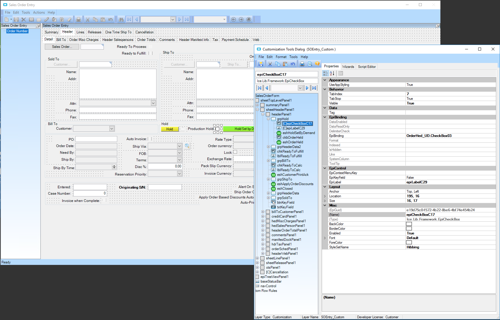

I am trying to bind a checkbox that I added onto the Sales Order Entry screen called production hold. Not sure what I am missing here, but when I check it, it doesn’t write to the database when I query that table and field. I have not messed with CheckBoxes yet. I have it tied to OrderHed_UD.CheckBox03 right now, but like I said, it just isn’t working.

Generally, any UD Column added to a table gets a “_c” suffix.
Verify this in UD Column Maintenance.
  1. Make sure your Data Model was regenerated after you added the UD Column.
  2. Change your binding to OrderHed_UD.CheckBox03_c
Also be sure to restart your Epicor appserver and client so it can get a refreshed copy of the data model
Odd. None of my columns in OrderHed_UD have the “_c” suffix. Will the “Regenerate Data Model” fix that or do I add that manually in UD column maintenance, and then regen?

So I guess my next question is what am I doing wrong with this case of this checkbox? Do I just need to regen the data model and that will work?
  1. Confirm the name of your field in UD Column Maintenance
  2. Regen Data Model from Admin Console
  3. Restart all Production (testing, development, whatever environment you are working in) AppServers
  4. Restart your Epicor Client
  5. Confirm name on you checkbox EpiBinding property matches step (1)
  6. Profit
Thanks Joshua! I will try this over the weekend since I cannot reboot appservers during the week. Fingers crossed!
about the “_c” thing… if this field existed in your instance of Epicor PRIOR TO v9, those original “extra fields” did not gather the “_c” through the normal upgrade processes.
ok. That is what I was wondering because a LOT of my UD columns do not have that suffix. I will see what I can do over the weekend and update you all. Thank you so much everyone!
