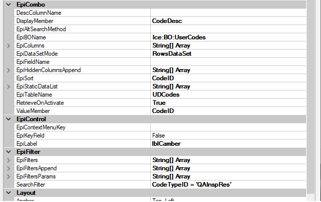

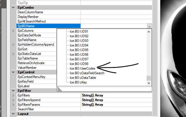

If it’s a finite defined list, like this, I’ll usually create a user code and tie the EpiCombo to the UC BO. You can also use Extended Properties to tie the underlying data field to the UD Codes. Then, when I add a combo, merely binding it to the custom field will default to the correct config.
Otherwise, I’ll use a BAQCombo.
I cannot type values into combobox configured as above. Though, that’s not specifically why I go this route. I, as a rule, try to avoid hardcoding static lists into a form customization.

Mike,
You don’t need to do any special binding on the field if the field you’re using is an Epicor field. For example, suppose you add a UD field to JobHead called “Results_c”. Here’s what you do:
  1. Create a User Code, example: “JobResults”, and you list the values you want to be valid for those results.
  2. Go to Extended Properties, pull up the JobHead_UD table, go to Results_c field, and add the User Code (JobResults) to this field.
  3. In the form customization, add an EpiCombo, bind it to JobHead.Results_c. You’ll notice a lot of other fields automatically fill in for you - Epicor does the work to have this come from the UserCodes table with the filter for the JobResults code.
Note: changing the extended properties makes a change to the Epicor schema. I usually have to log out of Epicor between steps 2 and 3, give it a few minutes, then log back in.

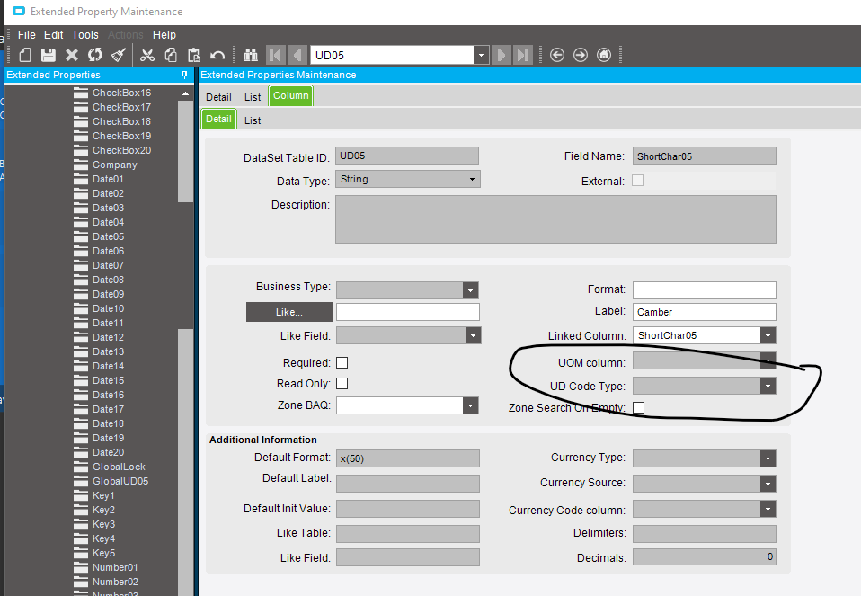

Hey Kevin thanks for the response. Question Does this work with built in fields of a UD05 Table? I see where you can add the UD Code Type on the fields in UD05_UD but that field is not available in the UD05 table per the image below.
I figured it out thanks. I saw where the Properties of the combo box were changed using the wizard and applied those changes to the other EpiCombo’s I wanted to change.
