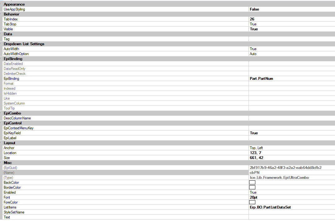

How are you binding your ComoboBox?
With search wizard for adapter then:
Why don’t you use the Standard Epicor lookup for your dropdown? I am confused. What does your code look like and what’s the end goal? (function wise)
Well I’d LOVE to use the predictive search out of the box but my issue hasn’t been resolved with that yet.
I am using a combo as a predictive search for PN.
	private void SearchOnPartAdapterFillDropDown()
		// Wizard Generated Search Method
		// You will need to call this method from another method in custom code
		// For example, [Form]_Load or [Button]_Click
		bool recSelected;
		string whereClause =string.Empty;
		System.Data.DataSet dsPartAdapter = Ice.UI.FormFunctions.SearchFunctions.listLookup(this.oTrans, "PartAdapter", out recSelected, false, whereClause);
	if (recSelected)
			// Set EpiUltraCombo Properties
			this.cbPN.ValueMember = "PartNum";
			this.cbPN.DataSource = dsPartAdapter;
			this.cbPN.DisplayMember = "PartNum";
			string[] fields = new string[] {
					"PartNum","PartDescription"};
			this.cbPN.SetColumnFilter(fields);
	//this.cbPN.LimitToList = true;

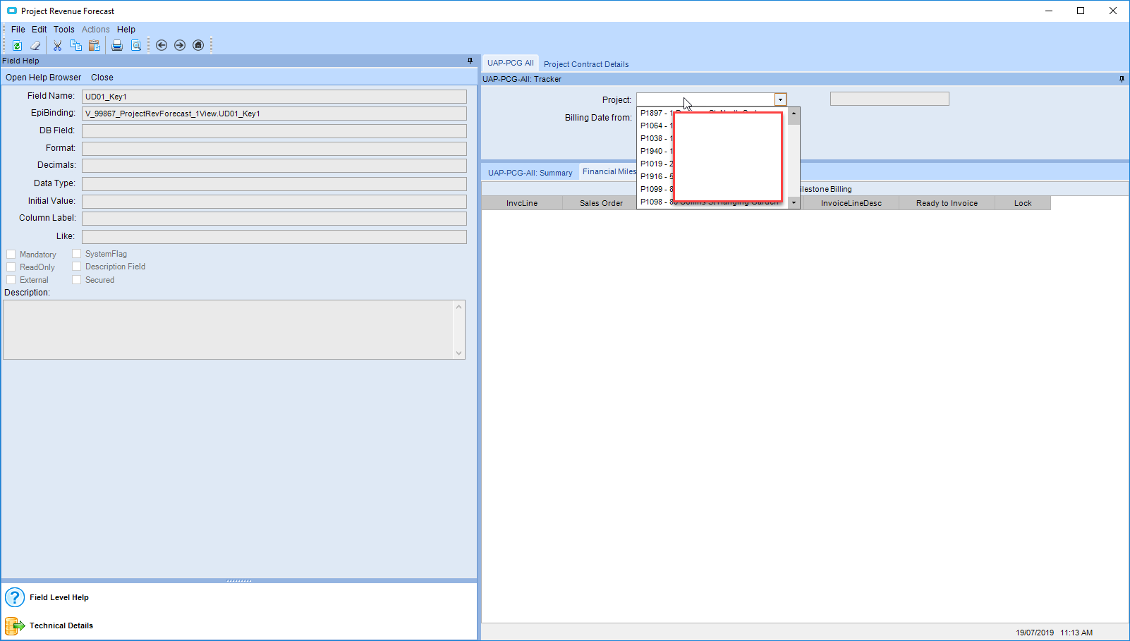

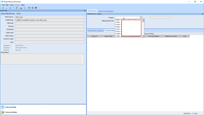

Hi everyone,
I am also looking to sort out Project ID in an Epicombo. thought it’s a best place to post for quick response.
We have a customized customized dashboard- project revenue forecast. The dashboard contains a drop-down menu, where users can choose a particular project and hit refresh button to get the information on the project. A BAQ at the back end pulls out the information that is shown in the dashboard.
However, the projects do not come in order in the drop-down menu. Therefore, I want to know whether there is any way I can sort the projects in the drop-down bar.
Please let me know if you have some suggestions. Will be looking forward to hearing from you soon.
I have attached screenshots below.
