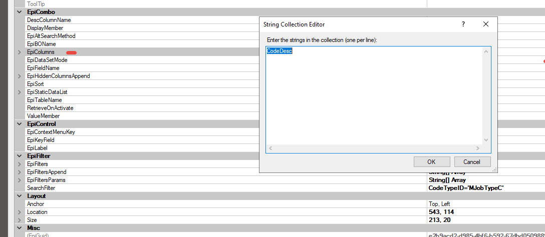

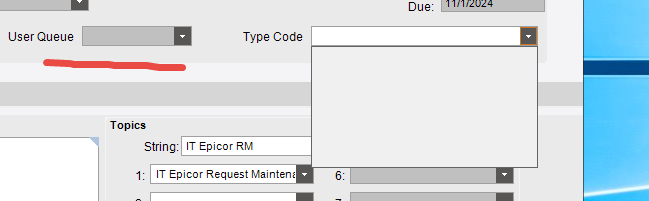

I am trying to use User Codes to fill a drop down EPiCombo box on a screen customization. I can’t get the dropdown to populate. I’ve read through everything and it looks like it’s set up right to me :frowning: What am I missing?

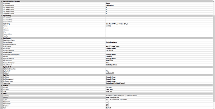

Change ‘CodeTypeDesc’ to ‘CodeDesc’ & chose ‘RowsDataSet’

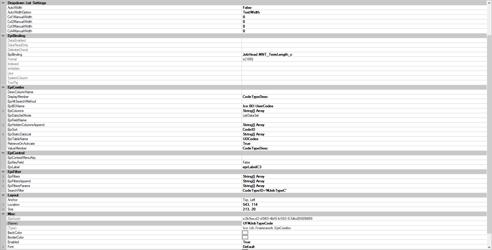

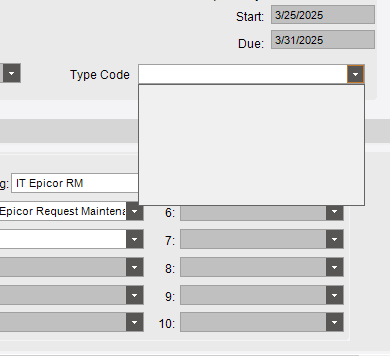

That helped a little :slight_smile: I get the drop down but there’s no values in it :frowning: I double checked that there are description values in the User Codes.
And I have another one that I set up the same way using a different User Code list and it doesn’t drop down or anything
Double check your filter.

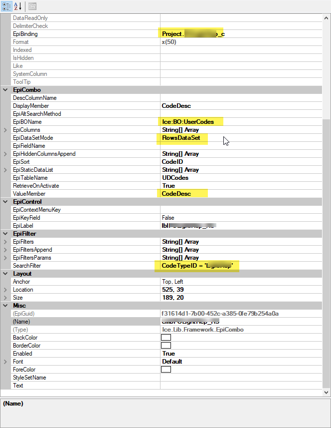

@MelissaC I have this doc from an Insights many moons ago. I’ll look for my screen shots I made too. Only things I’ve had to set are highlighted below I’ve never had to go into string editors for a UserCode combo.
Fun with Dropdowns.pdf (279.4 KB)
I don’t have anything is either filter… Should I :slight_smile:
Filter should be CodeTypeID='YourUDCodeLibraryName'
I gave up and did the customization in the new Kinetic screen :slight_smile:
