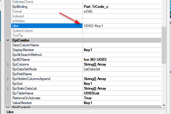

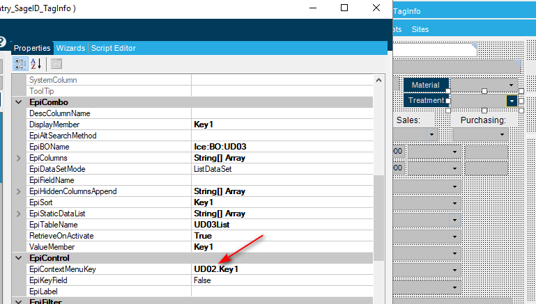

I have two UD fields on part entry: UD02.Key1 and UD03.Key1. UD02.Key1 works fine, opens the correct quick search, context menu is correct, etc. UD03.Key1 always brings up the context menu for UD02.Key1. EpiContextMenuKey = UD03.Key1 saves correctly, but on reload of the form it has reset to UD02.Key1.
The button next to each field works correctly, just the EpiContextMenuKey is broken. Any ideas?

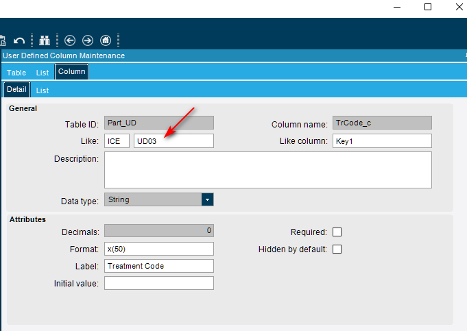

I added another UD field to the table, making sure to set the “Like” appropriately, regenerated,and replaced the field in the customization. Same result. The “Like” field in the entry screen properties defaults to the wrong UD table and cannot be updated.

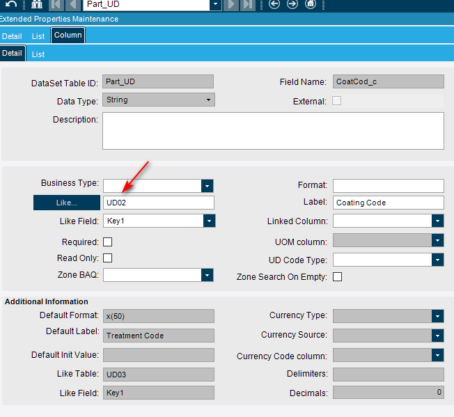

I could have sworn I had already checked Extended Property Maintenance for these fields, but apparently I missed the obvious cause.
