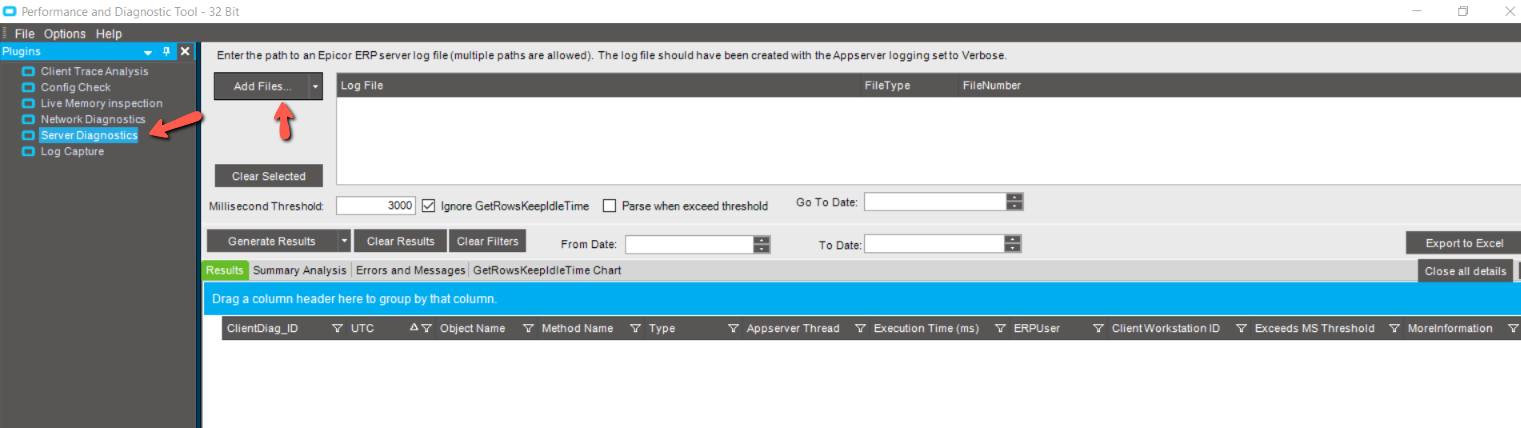

The process is the same for adding files to the Server Diagnostics.
Make sure you select Server Diagnostics in the Plugins section on the left. You can either point the tool to the server log directly on your application server or copy the file somewhere and read the data from there.

You first have to setup where you want to store the server log. You do that from the admin console and select Application Server Settings. There you will specify the file location for the server log file.
