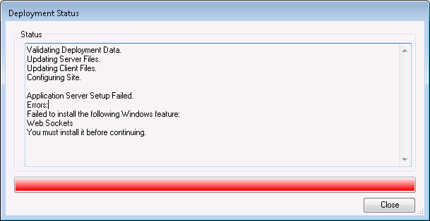

What am I missing here… I had this setup before and now I can’t seem to get it to deploy again.
I’ll start with this is a Server 2008 R2 setup (yes I know old IIS) but I was able to get 10.2.700.12 to work after installing IIS 8.0 Express. I removed everything from the server and restarted back at 10.2.400 to see if I could get a side by side install going and replicate what I would like to do on my live server. I need an environment available to train users on the changes and have it be comprable performance to what they will see and I have no other servers available so side by side is the only option. Everything for 10.2.400 went back and was running fine with my live database, so I went to install 10.2.700 and I’m getting as far as the deploying of the appserver and it will crash saying it could not install WebSockets I need to enable that feature to work. I’ve tried removing IIS 8.0 express and re-installing it and still the appserver won’t deploy.

If I had to guess I’d say you are missing a dependency which is likely not avaialble in Server 2008… could you upgrade that environment?
Under App Development Feature in Windows Features you can enable Web Sockets. Is that enabled? It’s not enabled by default for IIS installs.
Josecgomez, if that was an option I wouldn’t be bothering to fight with this. I have no budget to upgrade anything, stuff has to die before they replace it.
Chaddb, I do not see that option anywhere in features, as well as I had this working last week… I only uninstalled it all to get 10.2.400 up and running and do a side by side upgrade. The server base config didn’t change from last week to this week which is why I’m so confused on how I was able to use it then but I can’t now.
I think the Web Socket feature was actually introduced in Server 2012. I take back enabling that feature. It may be supported in IIS 8.0 but I’m not sure how you enable it. Unless it’s enabled by default. But I would agree with @josecgomez that there is probably a dependency or something you’re missing. I’m guessing 10.2.700 requires something 10.2.400 doesn’t. Not sure why it worked and now doesn’t.
Yes natively it was introduce in 2012 hence the question here. I had it running with just installing IIS 8 Express before but now it’s not taking.
Maybe take a look at this. IIS 8 and Server 2008 is pretty old now.
I mean… if you can’t install software due to the age it’s effectively dead lol
That only works for IIS 8, not the express version… I guess the best thing I can do is a full system restore on this box from last weeks backup. That’s the only way I’ll get that working environment back.
I wish it were that easy to convince… but the issue here is, that’s not the live environment. Technically I should be able to install this without a problem on my live server since that’s 2016.
