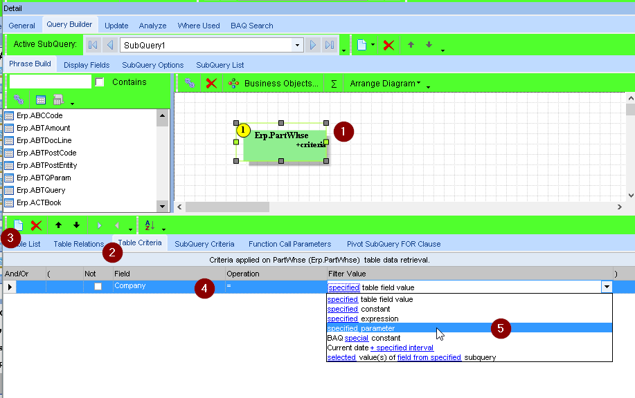

In a BAQ, you can add criteria to a Table, to limit the records fetched.
  1. Select the table in the designer
  2. Select the Table Criteria tab
  3. Click the icon for Add Row
  4. Select the table’s field to use for the condition

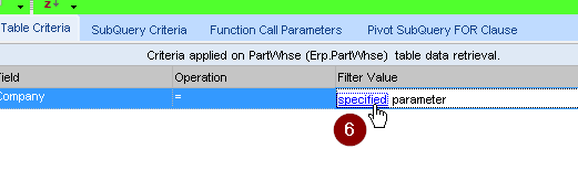

  5. Select the specifies parameter
  1. Click the underlined “specified”
  1. In the pop-up wind select the paramter you created.

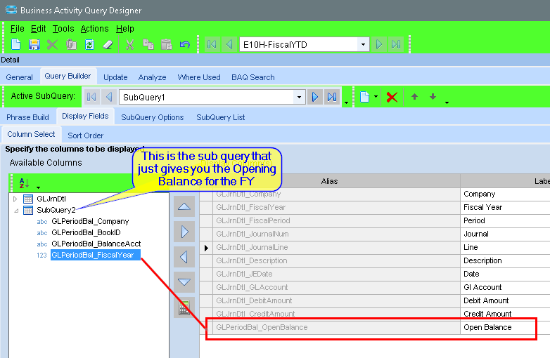

Fiscal period 0 of GLPeriodBal will hold the opening balance for the Fiscal Year.
You might need to make a subquery the has just the GLPeriodBal table, with table criteria of
OpenBalance = constant 0. In the columns for that subquery, include: Company, BookID, BalanceAcct, FiscalYear, and OpeningBalance.
Then add that subquery to your mainquery, linking the Company, BookID, and FiscalYear to the exist query. Finally include the OpenBalance column (from the sub query) to the list of columns on the main query.
Ok got it. Sorry, one more question. What do you mean by “include the OpenBalance column (from the sub query) to the list of columns on the main query”? Thanks.
You don’t have to include it as a column, it can be used in a calculated field. But if you’re going to do some of the summation and what-not in the Report, then you’ll need this value in the dataset.
The following shows a very simple BAQ of the GLJrnDtl table. all but the last column come from this table, and the last comes from the subquery that gets the Opening Balance for the FY.

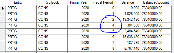

I’ve recreated a simple query, using defined parameters (=) around FiscalYear and BalanceAccount. Below is snip from query:

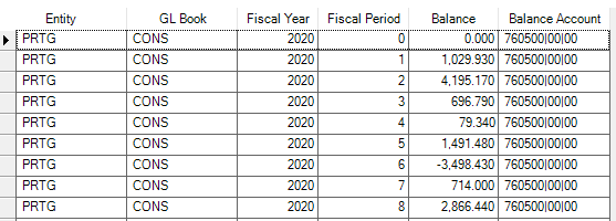

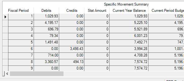

And here is snip from chart tracker:
Notice how the balance from the query is only the monthly activity, not the running total.
My other issue is that the query doesn’t return 0 balances. So if an account has no activity in a period, it won’t pull that period into the query, even though I’m telling the query to run all periods:
Notice how the query in this example skips period 3, because period 3 had no activity in that month.
