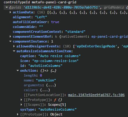

I believe it’s a method that needs to be called vs. a property that does a one time adjustment, I saw it a while back when I was tinkering but cant remember now.
If you do ctrl-alt-L and walk through the component properties, if i remember it is under ComponentInstance somewhere.
Something in here:
Maybe you just need to trigger that action id.

How would I go about calling this method / action ID? I thought I would place it in a next event widget but when I went to put it in there it does exist.
Well, I only really know that an action lives on the 3 dot menu and you can also make it a clickable button. I’ve only done it where an action is already set up to call an event, and i trigger the event manually instead of via the action.
In this case, the action triggers some javascript code in main.js, so we lose that ability and need to trigger the action.
Maybe some javascript could trigger the action if we cant do it out of box in App Studio…
I’ve never tried.
