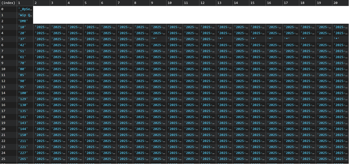

I have a blank dataview that gets populated by a function. That dataview is then populating a grid. When the event triggers for the population call the grids end up looking like this:

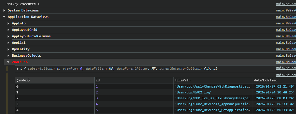

in your app, in browser, ctrl-alt-8 to turn on debugging, hit f12, go to console tab, then back to your app.
ctrl-alt-L then back to console, you should see component model trees dumped to console, you can find your panel card grid and expand → the tree to navigate through gridmodel columns.

You should be able to hit ctrl-alt-8 then ctrl-alt-v to display the dataviews, and see your data in your defined dataview.

What the dataview looks like currently after the function runs:
If you are pulling in the same number of columns, you are going to get the same amount of squishiness. how many are there? Populating the dataview from a function should be just fine, you don’t need to do it via a baq.

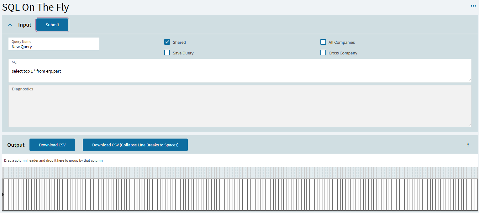

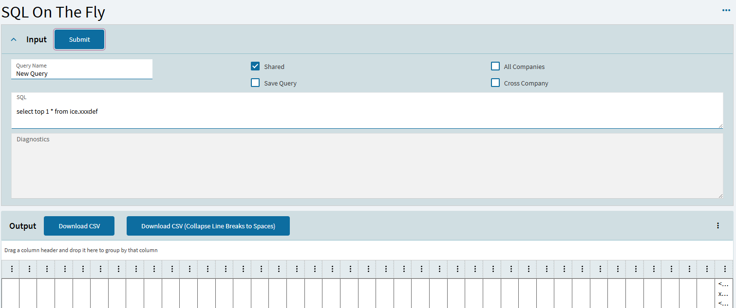

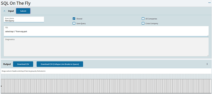

I do the same logic with my SQL On The Fly dashboard that lets you run SQL in cloud. Since the input SQL may have any number of defined columns, I must handle them dynamically.

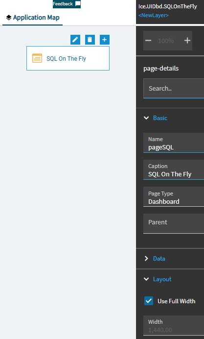

Also, in App Studio, on your App’s Page, set “Use Full Width” under Layout section.
This will let the app stretch to the full width of an ultrawide display, I use a Samsung Odyssey G9 5120x1440 and this works well to see a grid with many columns like this.

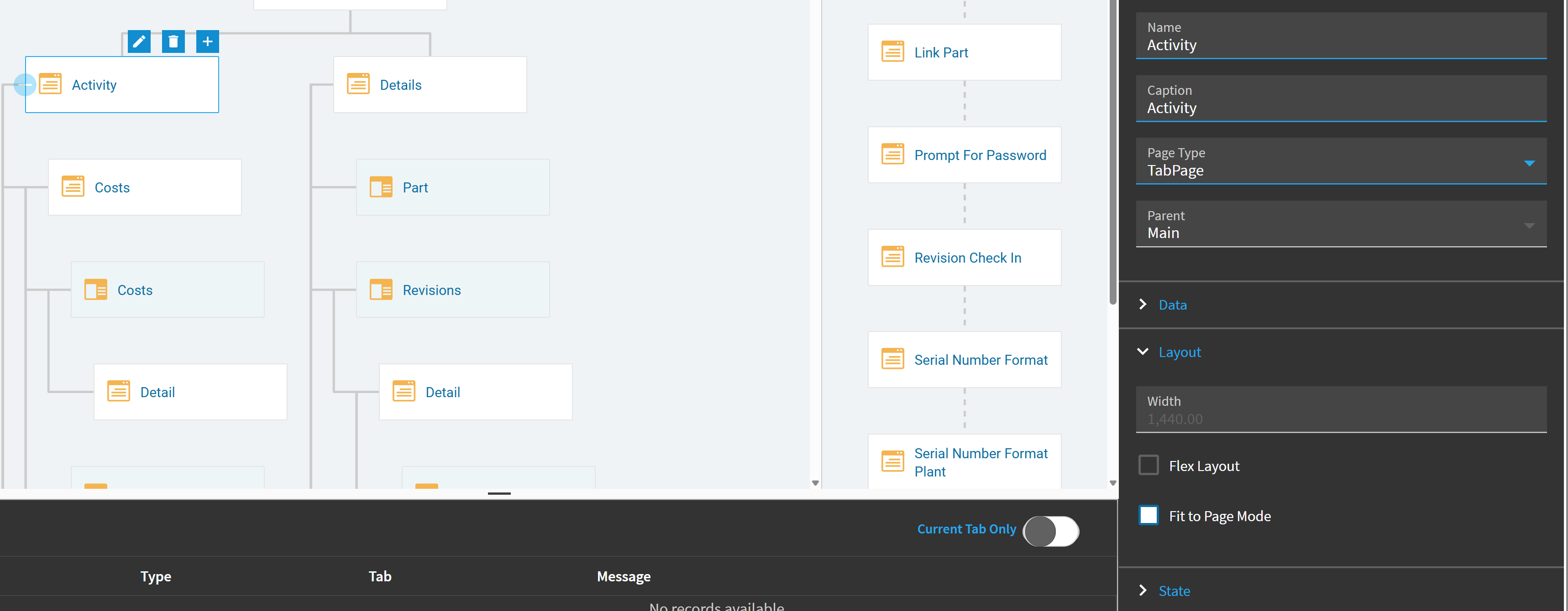

I tried this out and unfortunatly it doesnt widen the columns for me. I also checked in our version of Epicor and I do not see the “Use Full Width” option on our screen.
When trying the “Fit to Page Mode” it broke the page and I had to roll back to a prior version.

Oh, it’s been a while since i’ve used that older version, definitely Kinetic has had some nice changes since then that improve the usage. You should consider upgrading if possible. (of course i know that is not a trivial statement)
I think that use full width may be only available on the base page for the app vs. the activity page, check there.

You were correct that the “Use Full Width” option is only available on the primary page. After enabling that, I didn’t see any change on the screen.
