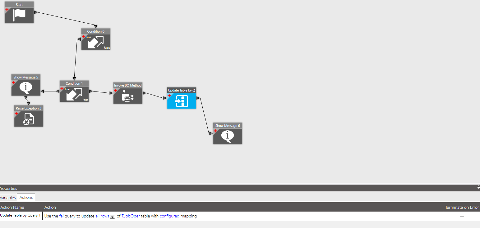

Hey everyone, I am having some issues trying to get a BPM to work. I am used to programming this in C#, so I am trying to learn how to do it this way. Here is my BPM:

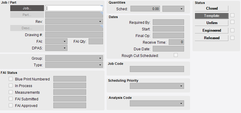

This is what I am trying to do. When the released checkbox is checked, if the job is an FAI, then the fai quantity on each operation is automatically updated. On Job entry I have 2 custom fields, FAI status, and FAI Qty. Fai status is a combo that says if it is an fai or not. FAI qty says how many parts need to go through fai inspection Shown Below.

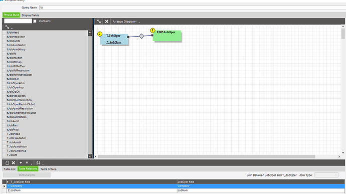

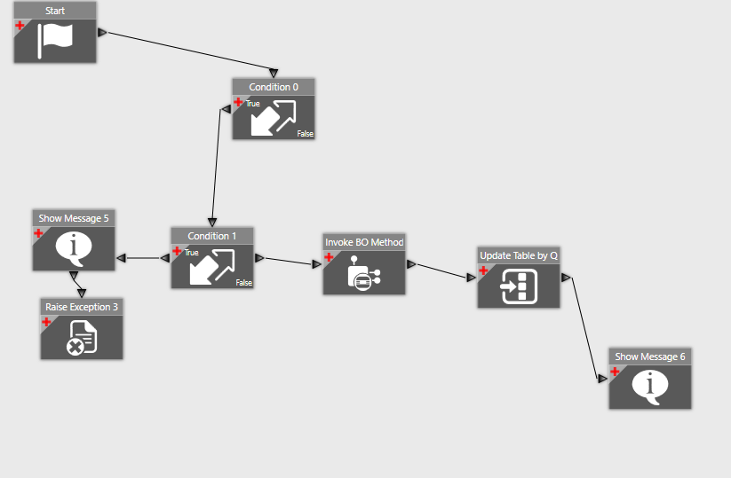

The BPM “Condition 0” is checking if the FAI Field is set to FAI. IF it is, it continues, if not, it does nothing. “Condition 1” is checking if there is an FAI qty. if the job is an FAI, and there is an FAI qty of 0, then it raises an exception, and tells you to enter a qty. If the qty is not 0, then it goes to update the table. This is where I am having issues. I am trying to update the field “FAQty” for all operations that is on the current job. I invoke the BO GetByID for jobentry adapter. This exports dataset “T”. The update table by query looks like this:
For testing, I am just trying to update all FAQty’s to be 1, just so I know it works. When I run this, nothing is updated, what am I doing wrong?!?!?!
