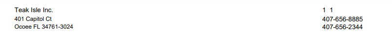

This is regarding the CustSt report style – which is a simple enough report except that the fields in the header portion still cause a PDF (1 page) to be created even though the customer data portion (lower portion) has no data.
This is because there are two datasets: 1) “Company” (for our phone, fax, etc) to show in the header and 2) “Customer_InvcHead_CashDtl_RptLabel” which is used to grab the customer statement details.
Since the two datasets are disconnected when the detail data produces no records, there is nothing to tell the Company dataset not to run so it always produces one semi-blank page (just some half-baked field data at the very top):
The real reason is the the customer detail dataset has a filter on it to only show where [OpenInvoice] = true and since that filter can’t be applied to the Company dataset, the Company query produces data.
