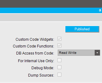

Do you have your settings set to allow writing to the Db?

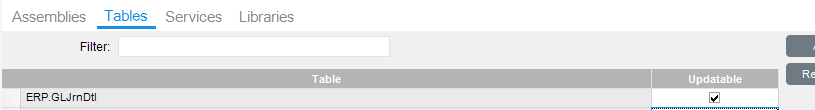

No, I didn’t. Looks like I need to check the updatable check box for the table also to make the error goes away.
Thank you very much for your help!
