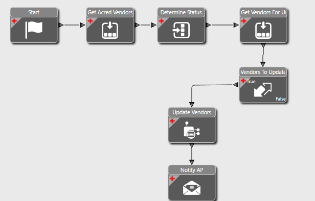

Has anyone else noticed That the Epicor Functions Diagram loses it’s flow connectors during some upgrades?
We recently upgraded from 10.2.700 to 2022.2.19 and we noticed this.
I didn’t take the time to see if they are actually broken, I just rebuilt them.
Before:
After:
I’m glad I labeled my widgets.
@Rick_Bird, We discovered this during our upgrade from 10.2.700 to 2022.2 as well and reported it under Case CS0003470657 / Problem PRB0261382.
The temporary work around is to use 2021.2 as an intermediary. Export your functions from 10.2.700, import into 2021.2, export from 2021.2, import into 2022.2 and the connections will remain in place.
