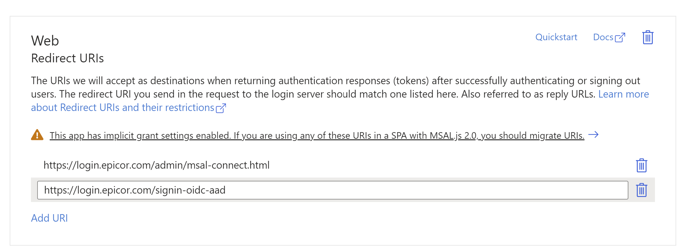

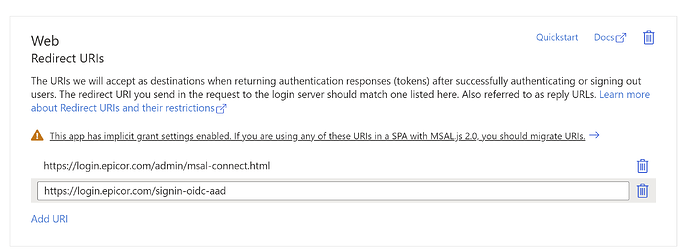

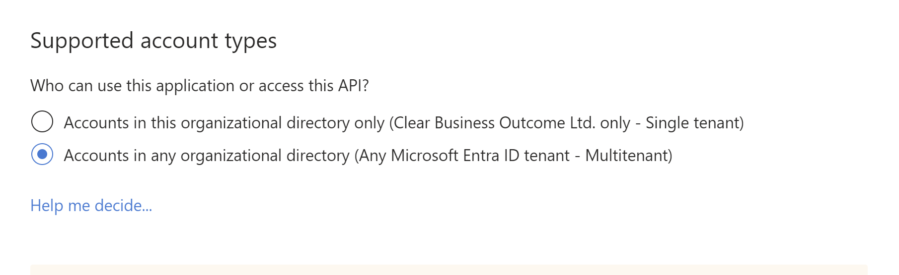

You do need to mark the App Registration as Multi Tennant, and we have had no issues in doing so.
You mention a login URI, however you do not need to set a login URI, just a redirect URI.

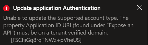

I am having issues marking it as multi-tenant. This is the problem I get when trying to mark it as multitenant:
The login URI that I mentioned was a mistype I meant to say that the Application ID URI found under “Expose an API” is not on a “tenant verified domain.”

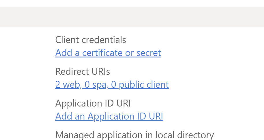

I am not sure what steps you did to have the App registration in Entra have an Application URI. As the application i have set up in our tennacy does not have an Application ID URI.

Removing the application URI solved the problem, thank you so much! I wish Epicor provided better instructions for how to configure the settings in Entra ID
