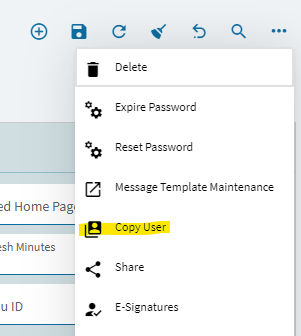

Not sure when this showed up… but (2024.1.15):
There was an Idea (combination of several merged ideas) which says its slated to be delivered in 2024.2. But it is already in my 2024.1.15 environments.
The “Delivered” tag on the idea is dated 10/15/2024… so perhaps the .15 release is when it landed? Dunno.
Part of the Idea was to enable changing a User’s UserID. But I don’t see that functionality yet.
@Rich just pointed that out to me also, great to have this in the application.
