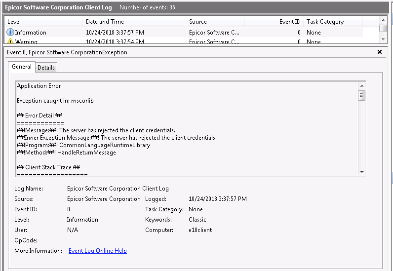

Thanks Jose, that did improve things. When installing on the win7 box that doesn’t work I now see all the config files. Unfortunately I’m still seeing the same error. Please note I renamed the computer and the account to only have lower case letters. Also, each time I start the client I see an windows error(see below). Finally I ran an md5 hash of the config files on the working and non-working boxes and the config files are identical. Any pointers / suggestions?

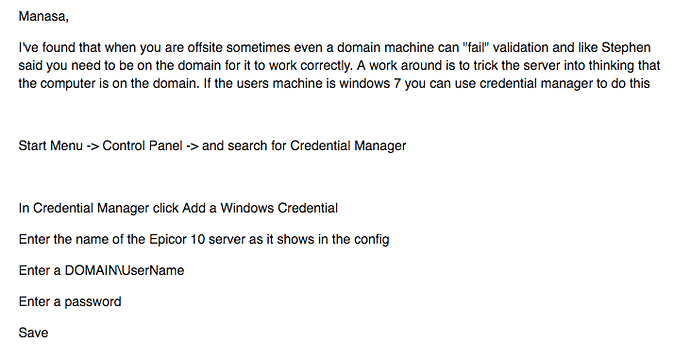

@josecgomez is the man, I actually found the answer in an old post on this forum from him as well. For anyone else with this issue below is what Jose wrote the solution was:
This resolved the issue for us.
