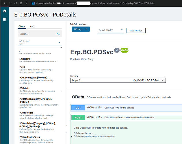

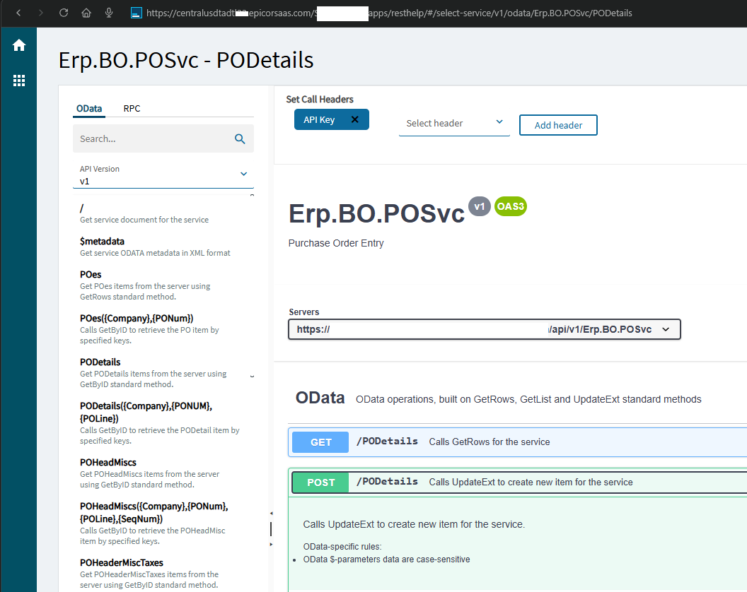

Using OData vs. RPC, POSvc/PODetails lets you POST to call UpdateExt and create a row:
I’ve never done it that way (didn’t even know you could!) - but I would think there’s been a signature change to this method and you need to adjust what you are sending. Maybe RESTHelp can clue you in. My first thought was maybe you need RowMod=A, but since it’s using UpdateExt, it shouldn’t be that.
As your error is part related, i would check the part master to make sure the part is valid in the company/site that you are working in, and that the part is not marked invalid and exists. following that, check that you might need to supply something for the various part fields in that dataset, maybe something changed to be required.
