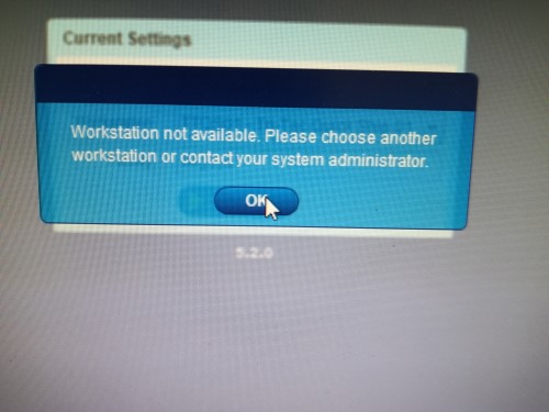

A user is receiving this error: Workstation not available. Please choose another workstation or contact your system administrator. Is this a simple restart for Epicor server?
Did you try and restart epicor first?
Is there another person already using that workstation?
With quick ship (newer version of manifest) I believe you can only have one person logged into a workstation at a time.
I believe she was the only person using her computer at the time. She had also mentioned this has been going on for the last week.
Is this in a web browser or part of the epicor client?
Which Insite Manifest version are you on?
We are using 5.2.0 Manifest
I believe this is part of the Epicor client. It has its own window not related to the browser.

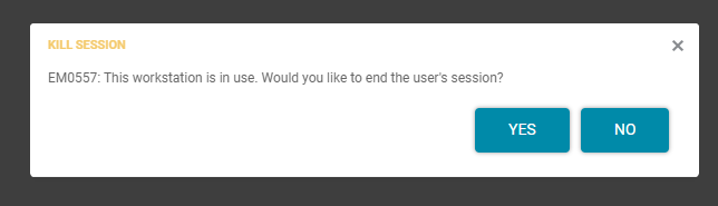

Correct. If someone is already in the workstation and you try to use it you get a message like this:
Is there a way to terminate all sessions of Manifest so we can test this on the users computer?
