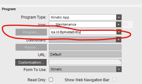

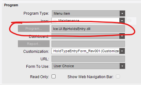

Hello all!
I am in the process of converting a lot of our screens from classic to kinetic. After creating a new kinetic environment to start doing this in, I noticed in menu maintenance that a lot of our programs that showed up when having “menu item” selected do not show up having Kinetic App selected. Does anyone know why this may be? As you can see in the photo example, BpHoldsEntry.dll is selectable with Menu Item but it does not recognize it for Kinetic App.
I’m no expert, but I suspect your BpHoldsEntry is a screen customization - and will have to be rebuilt on Kinetic (or you’ll be dragging the classic screen around until you do).
Hold Type Maintenance is still a Classic form for now even in 2025.1. It’s probably coming in 25.2, going into Power Tools, or being(has been?) merged into another form. Personally we don’t have any BPM Holds so…

Fair enough. Thanks for the help :rofl:
