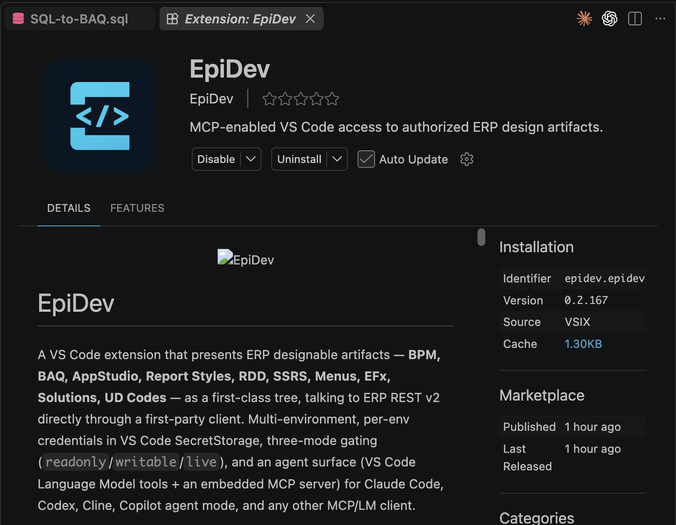

EpiDev is now available in the VS Code Marketplace! It will auto update in place from your currently installed .vsix.

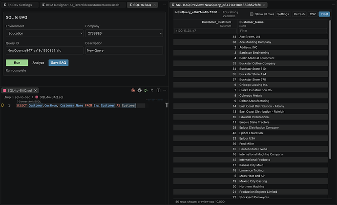

This version adds a nice SQL to BAQ editor! Type up your SQL statement, execute it, run it. adjust it as needed til you get the data you want, save it as a BAQ :slight_smile:
AI can of course still write the SQL or BAQ for you, but you know, if you want more control :slight_smile:
Awesome and good timing.

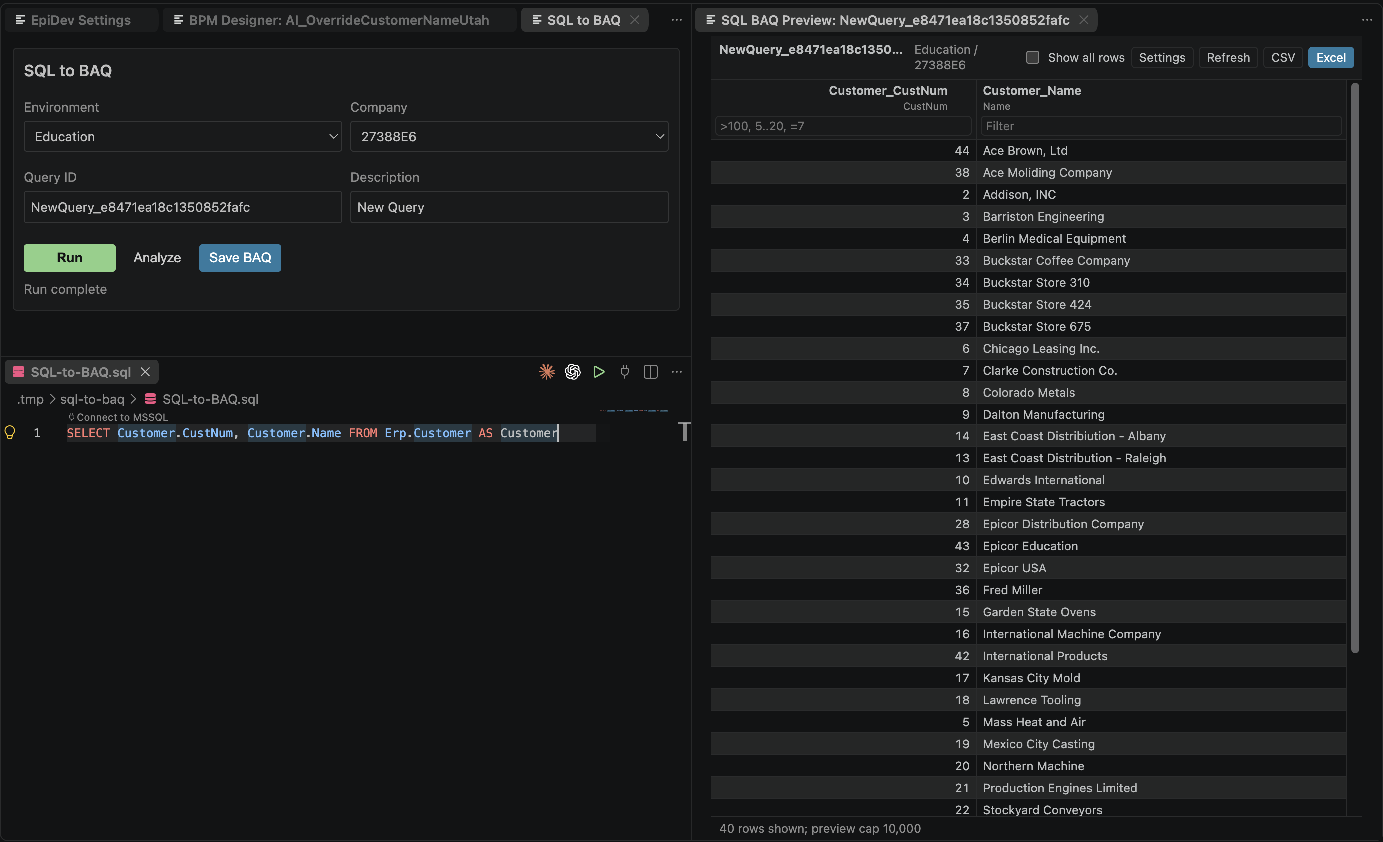

If my SQL to BAQ fails, how can I find out why? I don’t see anything in the output
Could you please dm me the input? It should be feeding back analyzeex output but it may be failing at the internal validation stage and not properly generating diagnostics.
Fix should be available in the VS Code Extension store shortly.
This was a silent failure on my internal BAQ validation - Epicor does not allow multiple instances of a table alias in a single query, each must be unique
I’ve included the relevant diagnostics output in the new build :slight_smile:

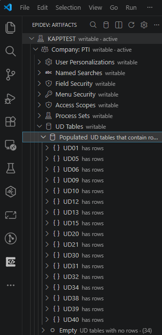

I really like this extension! There are a lot of hidden treasures. Want to know if you have used UD Tables?

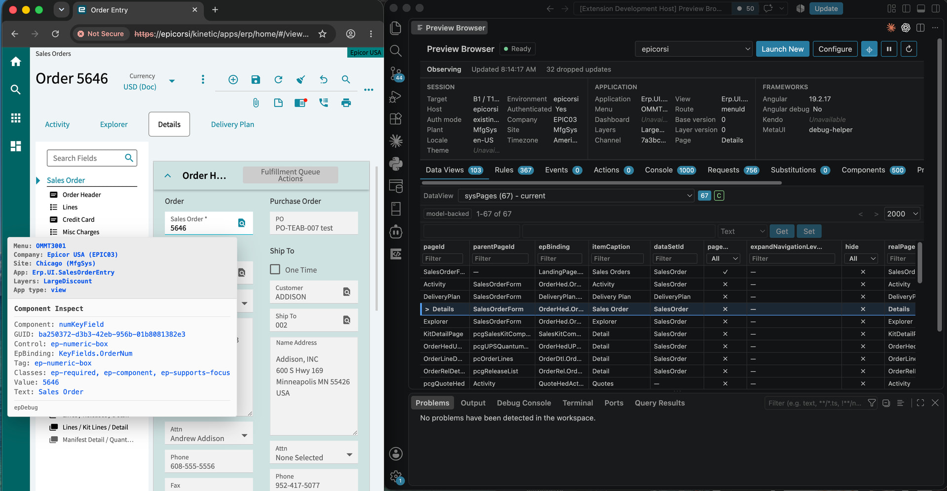

The latest version that is posting to the VS Code Marketplace now adds deep inspection of app studio components while running, and you can poke properties/dataviews live to see the effect (set / un set hidden, disabled, etc.)
I’ve also included the on-hover informational popup from Dev Tools that shows you the active company, plant, layer(s), etc.
