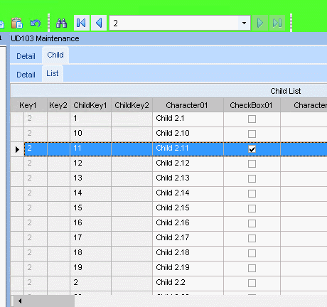

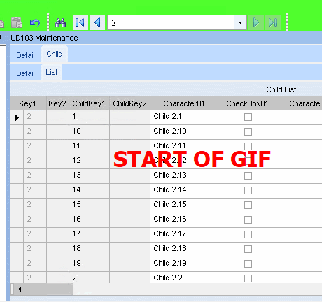

Experimenting with the UD103 Entry form, I think I can repeat it.
ud checkbox
The last visible row is not entirely visible. And when first clicked, the grid scrolls up a bit. Then the entire field’s contents are “selected” - like when you enter focus on a text or number cell.
I extended the window just a hair, so that a bit of the next row was visible, and it doesn’t do it.
ud checkbox2

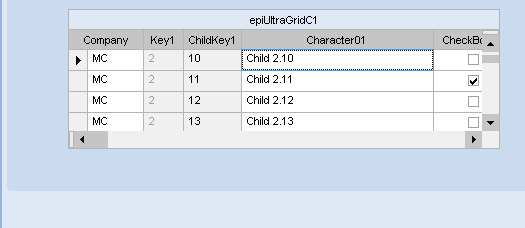

test3
