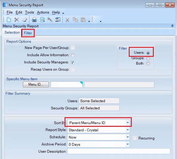

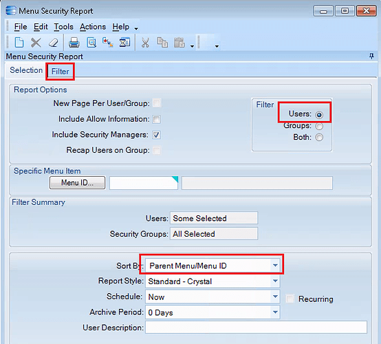

The easiest way I’m thinking of is to generate Menu Maintenance Report from:
System Management >> Security Maintenance >> Reports >> Menu Security Report
Filter by “System Manager” user for quick result.
Export to csv, then you have it all.
You can search and filter in excel.
Also, you might need to track parent menu in Excel in order to find menu exact location.

Thanks - the report is huge! I made a BAQ as the other person suggested.
