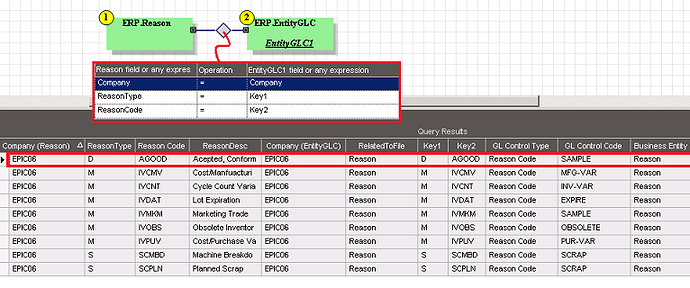

I am tying to query the inspection reason codes to display the associated GL Control Code and accounts. I can’t figure out the table relations. Looking for:
Reason Code : GL Control Acct
Thanks in advance.

Hi,
For anyone who still requires the Query Reason Code to GL Mappings, here is the BAQ attached.
MnzReasonCodeToGL.baq (28.0 KB)
