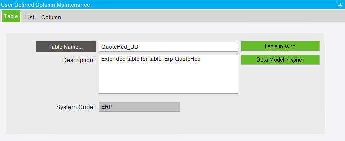

So… tldr: your error explicitly states that there is no “CheckBox01” column on the QuoteHed table. Have you actually verified that the column exists through SQL and/or through the User Defined Column Maintenance? Your screenshot and and original description keep referencing OrderHed.CheckBox01, which may be where the data ultimately ends up, but the Quote BO in the code is pointing at the QuoteHed table.
The column exists in the QuoteHed_UD table on all environments we have.
I have 3 environments currently running a 10.1.400.38, 10.1.600.23, and 10.2.200.13.
This is in all my 3 environments.
Table/Data Model are all in sync as well.
I think you might have grabbed the wrong sceenshot by accident - that’s the OrderHed table again. Your code looks like it should work, but I’d really like to verify that the QuoteHed table has a CheckBox01 column because that’s what the code and error reference. Can you show us a screenshot of the QuoteHed_UD columns?
