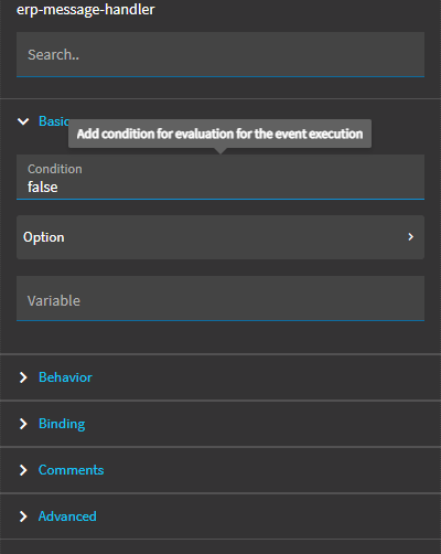

I use the erp-message-handler widget heavily for debugging purposes mainly. I would like to provide a true/false property to limit the execution to only when needed. I could put a condition widget before each one but this seems unnecessary. There is a condition section under the “Basic” section of its properties that should do what I want. I hard codded a false to test this but it executes anyway. Has anyone used this feature?

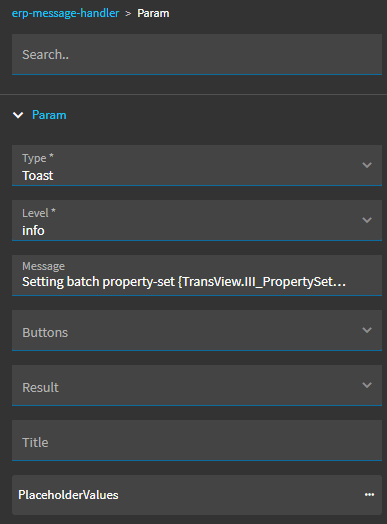

No. I just tried it again since we just upgraded a week or so back but it still does not work. At least not the way I think should. I mainly use it to display Toast messages under Advanced->Param. The condition portion is under Basic. These may be 2 separate areas/functions under the erp-message-handler that do not share values. The documentation, when I last looked, is lacking.
Lol, I asked about that and apparently that property isn’t even wired up to anything…
It’s on someone’s radar now and hopefully gets fixed soon.
For anyone else searching, as of 2024.2.7 this still doesn’t work.
