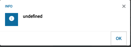

How would I go about doing this? I have gotten the message to show up with text only but have not had any luck getting the column name to show up. I get this

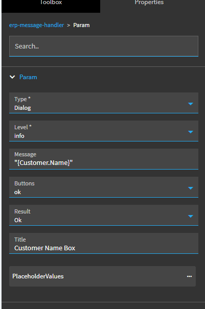

When I set up the message to print things, I go Advanced, Param > and change the format there. You can put data from dataviews in the Dataview.Column format. Could you say more on what you need? You might need to surround it in β€œ{Dataview.Column}” to get it to print.

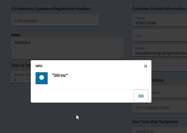

Here I called the Customer Dataview
See Customer Name prints from the Dataview.
EDIT: You don’t need the quotes, I did it again without quotes and it printed the text in the second screenshot without quotes.
