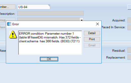

Epicor version 9.05.701
Problem: Not able to enter new asset US-94 - I get the following error

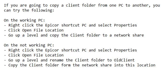

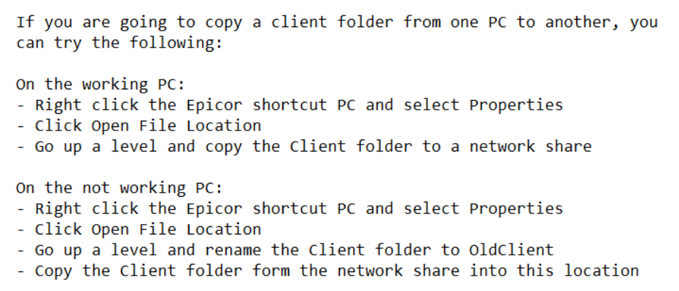

The epicor client and the epicor server has got out of sync.
Need to take a working profile (client) and do the following:
