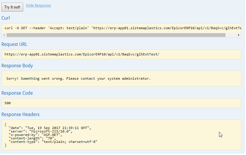

Sorry! Something went wrong. Please contact your system administrator.
And the Curl text auto sets to accept plain text
curl -X GET --header ‘Accept: text/plain’ ‘https://erp-app01.sistemaplastics.com/EpicorERP10/api/v1/BaqSvc/glhExtTest/
Any ideas why this would happen?

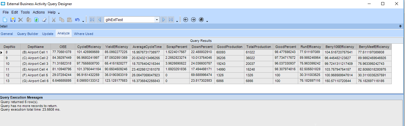

One thing not noted is that wen running the more complex version of the BAQ in Epicor there is no issue

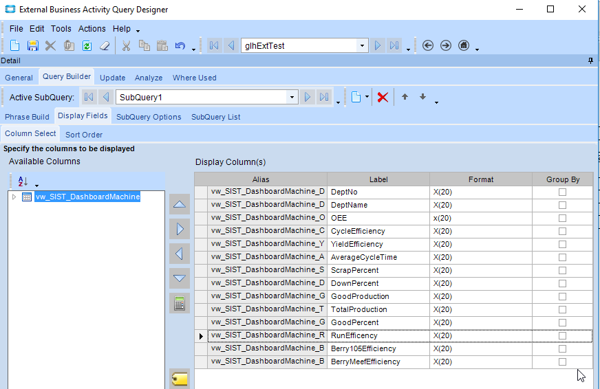

I changed all fields to String format

Image of BAQ Column formats
and BAQ return
Nothing that could be construed as anything other than a string yet still

String format does not mean string type.
EDM uses string in the case it cannot understand the type.
So the question is what is the actual type in those BAQ columns.
I think DeptNo is the most probably byte field. Can you remove it from BAQ temporarily and look if error changes?

After reading the link and understanding about 10% I decided to redefine my BAQ and only use Calculated fields for the output (I did try only defining a few but still had the same issue so I ended up having to do all of them). This worked.
