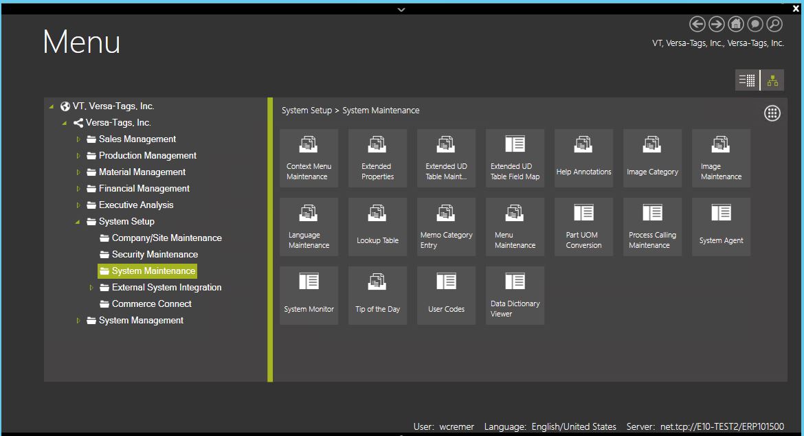

System Setup>System Maintenance>UD Column Maintenance
Yeah, I don’t have that in my system.
:face_with_raised_eyebrow:
Are you a security manager? Can you look in menu maintenance in System Setup>System Management?
Yes, I am security amanger and have acces to everything.
Ok in yours is Extended UD Table Maintenance
Says all of them are in sync.

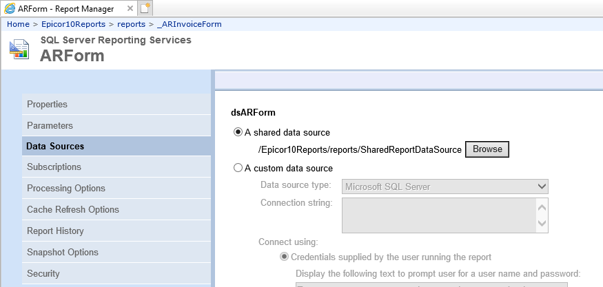

Did you change your data source on the migrated reports? That needs to be done to point the report data sources for each report in the custom folder to the appropriate data source of the new environment.
That was for my live environment on 10.1.400, and I just used my backup to fix it. Did nothing else. This one today is for my test environment 10.1.500. Hope that makes sense.
If you migrated reports from one server/folder to another (LIVE to TEST), you will need to change the data source of the migrated TEST reports to point to the correct data source. Give that a try if you haven’t already

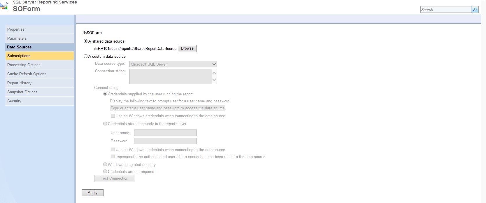

Just to make sure I haven’t missed something, here is a clip. Live=10.1.400.19, Test vm=10.1.500.38 Ihad checked this forst and didn’t see anything, but I could be mising something.
Yes that looks correct. Did you verify the columns exist in SQL?
