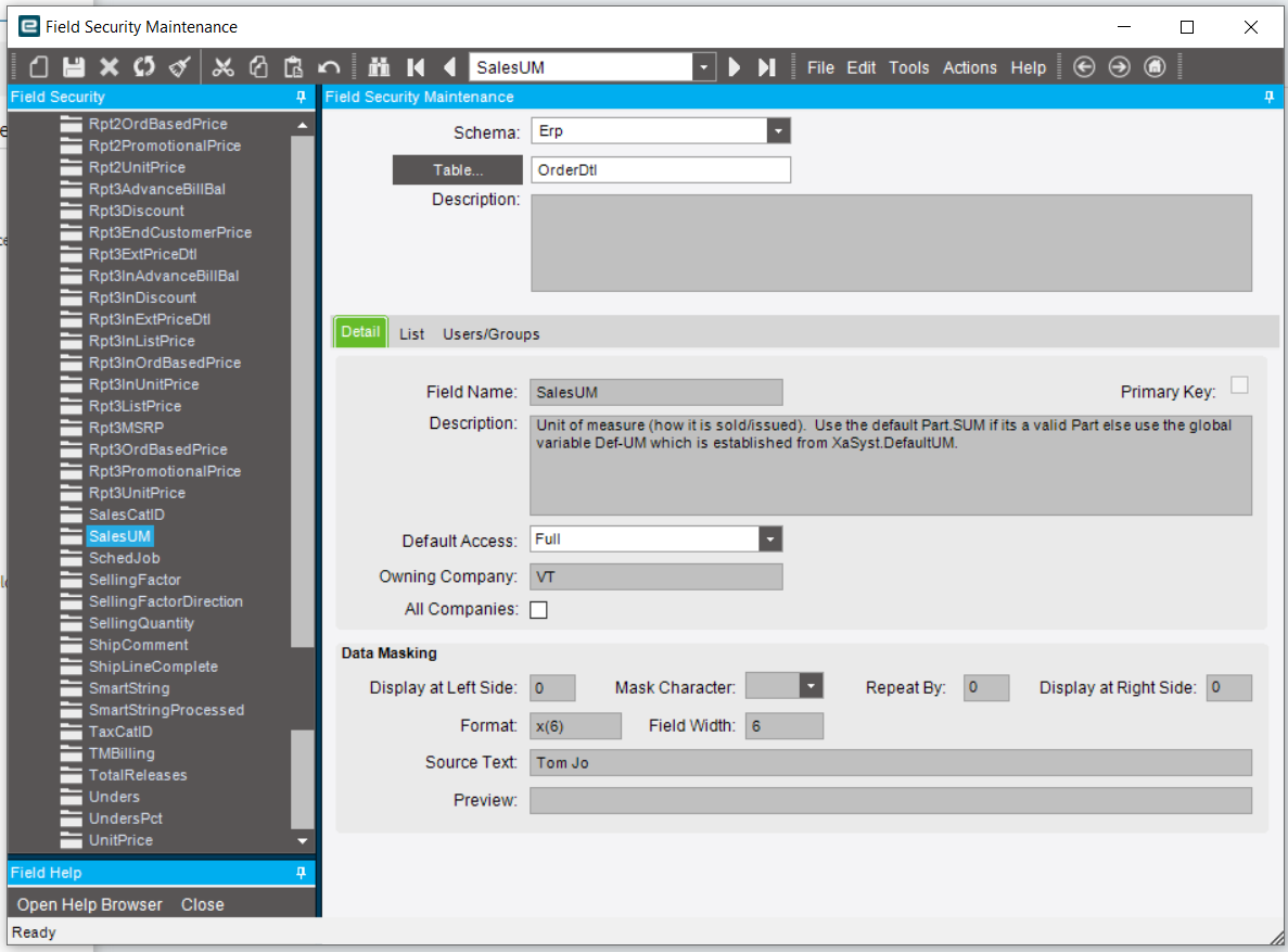

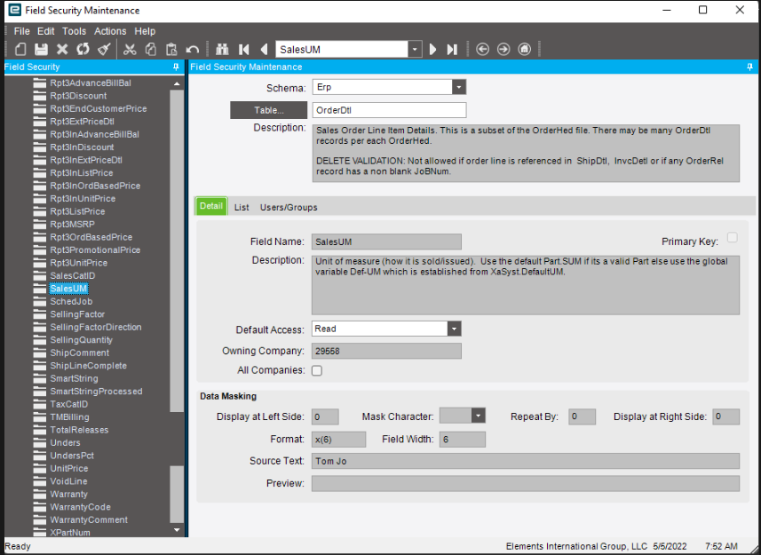

Hi Vicki. I found the solution to this problem. You have to go into field security maintenance and select the sales order table. Then make sure that the SalesUM record is not showing ‘Read’ access.
We also had this same problem on APInvoiceDtl_PartDescription and PODetail_PartDescription.
Hi Steven. Thank you for the info, but this one did not work on my end. I am not showing “Read” but “Full”. Looks like there may be mutliple fixes for this one. Still puzzles me its just this one user and not across the board.

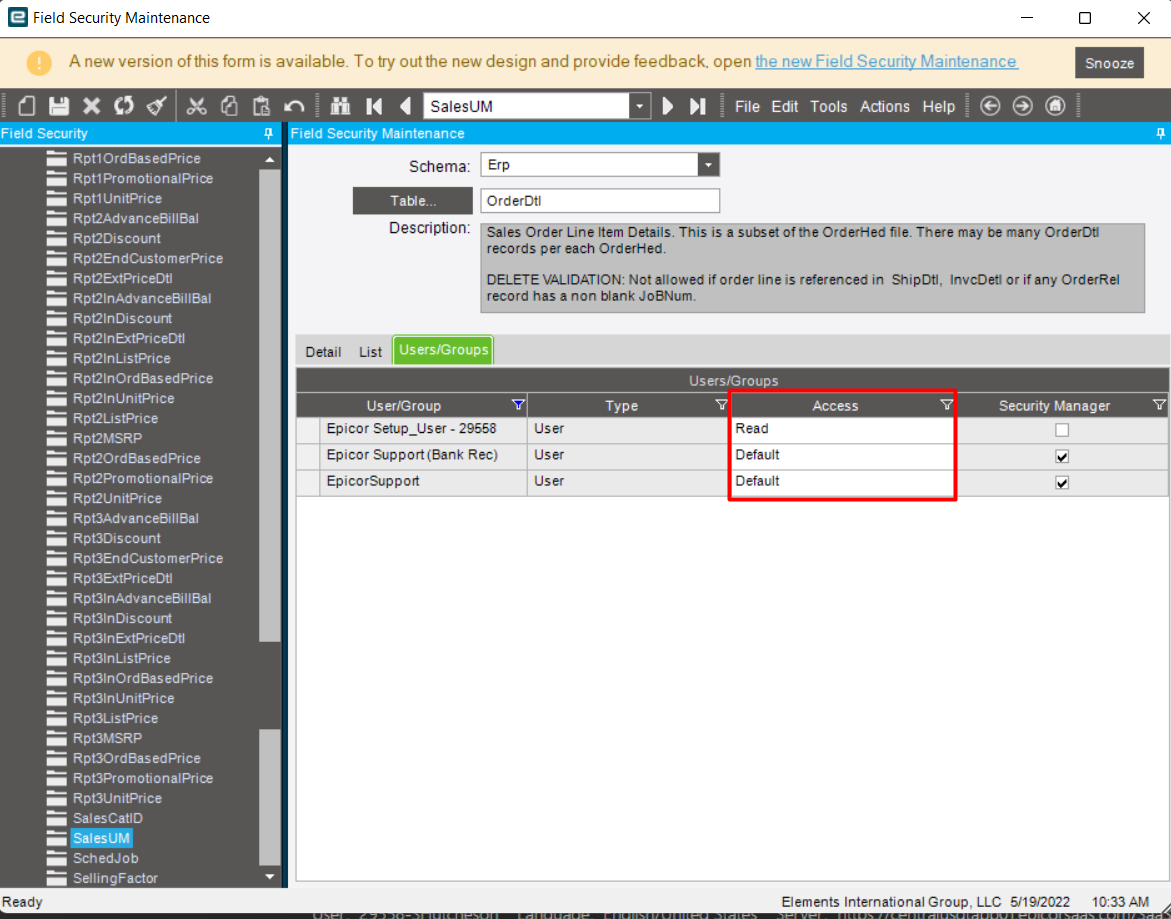

Look at the user groups too. If they’re listed as ‘Read’ then they’ll continue to have the same issue. You can select ‘Full’ or ‘Default’ and it should work for you.
Note that this wasn’t a problem for us if the user was listed as the security administrator.
All users are showing default. I tried to change this particular user to full to see it if helped. It did not.
