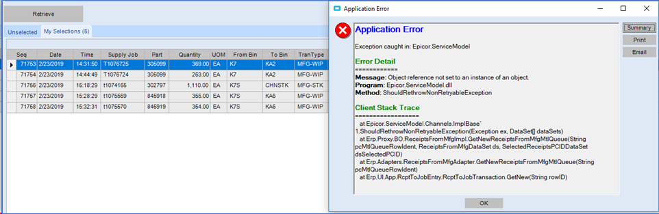

We are getting this generic error when trying to process MFG-WIP transactions (job receipt to job) in the Material Queue after upgrading to 10.2.300.8. We are getting this error on MFG-WIP transactions that were created in our old version (10.2.100.8) and also in the new version. Other transactions like MFG-STK and STK-MTL work just fine.
Has anyone had this issue with the upgrade? Any ideas would be appreciated.

No, we cannot do the MFG-WIP transaction from the queue. That is our problem. (We can do a manual MFG-WIP transaction outside of the queue and it works fine… but obviously leaves the row in the queue.)
When we try the MFG-WIP transaction from the Queue, we get that error and then the Job Receipt to Job window appears with nothing filled out. If we fill out the screen manually and click “OK”, the transaction does in fact happen (can see it in Part Tran Hist Tracker), but the row remains in the Queue like it still needs to be processed.
That’s what I meant, can you do the transaction from the regular client. I just wanted to see if we could isolate the problem to see if it’s the material queue itself, or if there is a problem with the transactions overall. So it sounds like it’s just a material queue problem.

FYI for anyone else encountering this issue… It is a confirmed bug in .300. The fix is planned for release 10.2.300.12 with an ETA of 3/13/19. (PRB0210647 in case anyone wants to review the details.)
