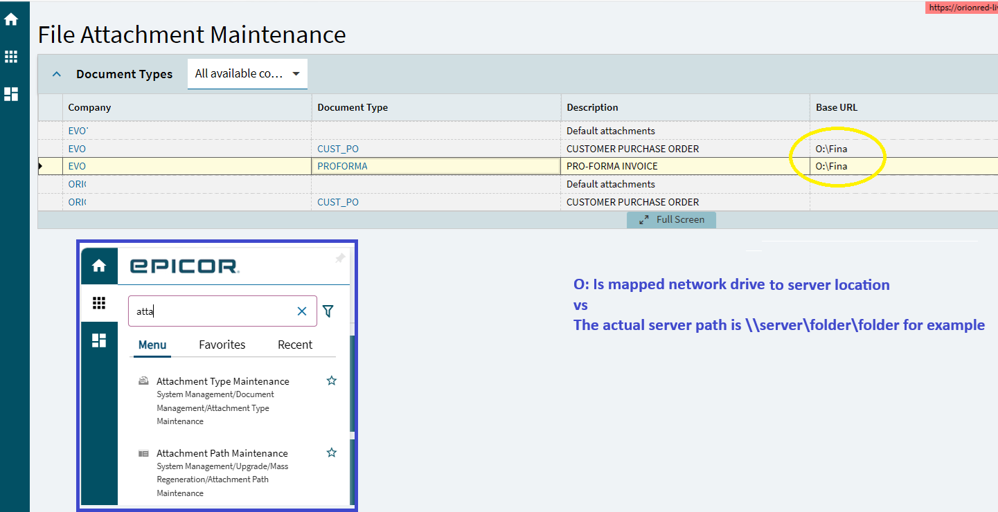

We have been unable to open attachments in Kinetic, the edge agent is attempting to open the wrong file path and I am not sure where this can be updated. Any help would be greatly appreciated.

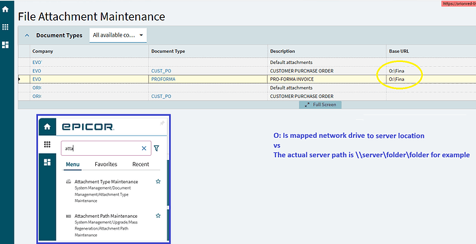

See screenshot for example of mapped drive letter vs actual server path. If a mapped drive letter is referenced in Epicor Attachment Path Maintenance, rather than the full server path, then confirm the client PC also has the mapped drive letter. Something to double-check.

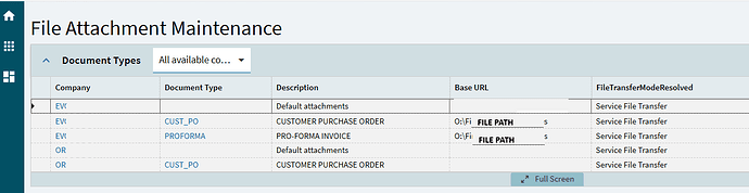

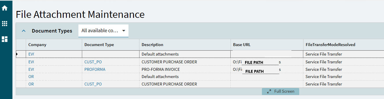

looks like it is set in Document Type maintenance, check it there
