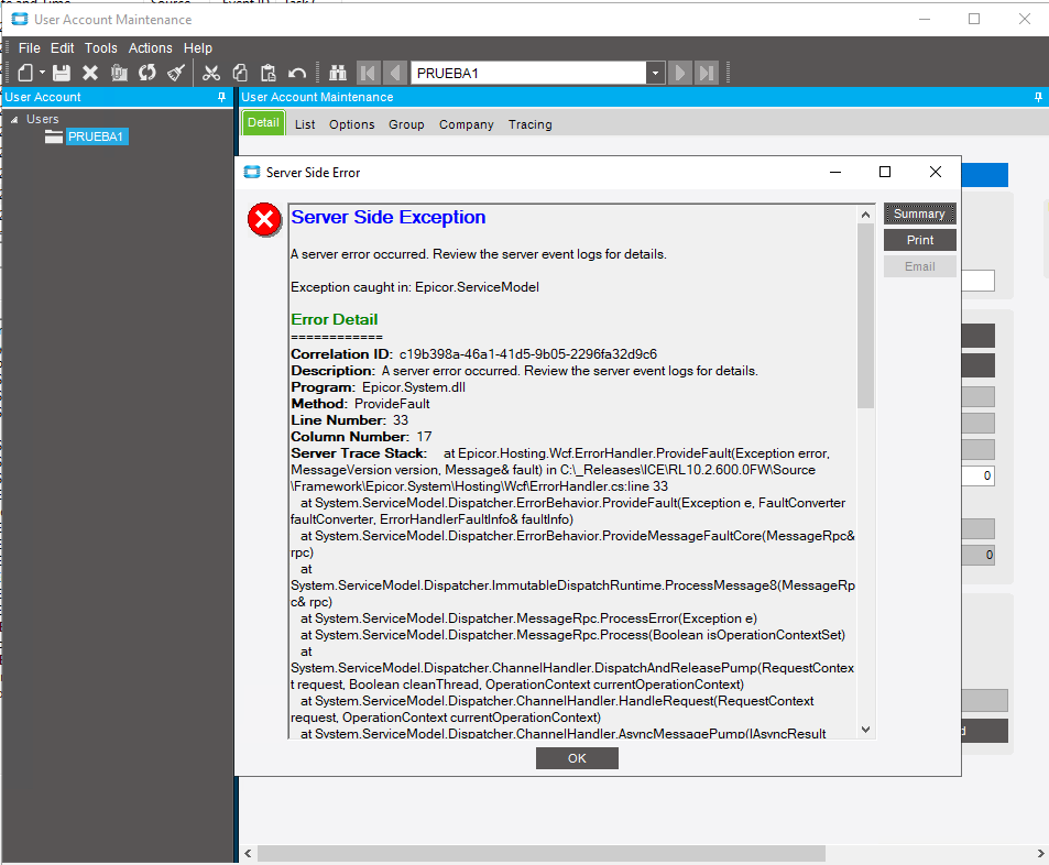

Hi,
When I am trying to create a new user in Epicor, it takes too long and after a while, it tells me that an error occurred and for more information, check the logs.
Server Side Exception
A server error occurred. Review the server event logs for details.
Error Detail
Correlation ID: c19b398a-46a1-41d5-9b05-2296fa32d9c6
Description: A server error occurred. Review the server event logs for details.
Program: Epicor.System.dll
Method: ProvideFault
Line Number: 33
Column Number: 17
Server Trace Stack: at Epicor.Hosting.Wcf.ErrorHandler.ProvideFault(Exception error, MessageVersion version, Message& fault) in C:_Releases\ICE\RL10.2.600.0FW\Source\Framework\Epicor.System\Hosting\Wcf\ErrorHandler.cs:line 33

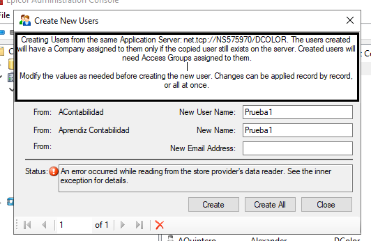

Have you tried creating the user in EAC on the server? If I recall, you can even choose an existing user to copy.
