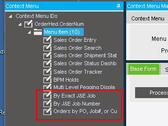

Also - Are there any custom contexts?
Here’s our Context menu Maint for OrderHed.OrderNum
The last three are custom. And if one of those had issues for just your user, that might affect your use of the Right Click

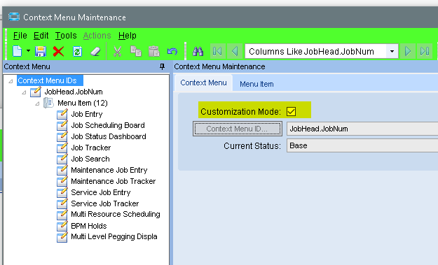

Check the Context Menu entries for JobHead.JobNum.
Are there any added ones?
Here’s what is built-in on 10.2.300 (Make sure you check the Customization Mode box before loading that context Menu ID)

It seems if I open up the context menu maintenance module and select JobHead.JobNum context menu ID, and leave that open then I can right click and open with from Job Tracker, Job Entry, etc.
As soon as I close the module, I cannot right click in the text box for Job number again.
That is what I show also.

Hey there, I know this is quite an outdated topic but in case anyone comes through looking for the answer to this I got it directly from support.
You must open the Context Menu Maintenance window, search for JobHead.JobNum,
when it opens you may see it says Current Status: Customization.
What you need to do is delete every item in the Menu Items menu from the bottom up including JobHead.Jobnum and this will trigger a warning saying it will be reset to base.
You can then uncheck the customize checkbox in the main window, you will visibly see the Current Status go to Base, save the window and close and reopen your epicor.
