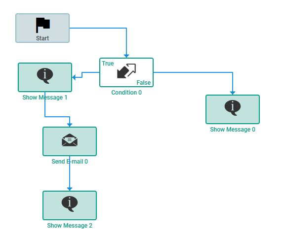

I am trying to create a sudo release notification for customers. I have added a new UD field on the customer that carries over to the Order called ASNEmail_c. I then have a BPM setup to check to see if the Ready to Fullfill checkbox changes from false to true and that ASNEmail_c is not “” Then it will send an email and in the to box i am sending it to that email address.

Have you tried to setup a message box to display the data in that field to ensure there is data.
Are you using code or widgets to process the BPM?
I get the same error when I try to use it in a message box… Interesting…
Seems like you may not have access to the dataset. What is your condition settings?
I found a work around. I created a variable and then tied it to the ASNEmail_c field and then i was able to add it to the BPM Email.
