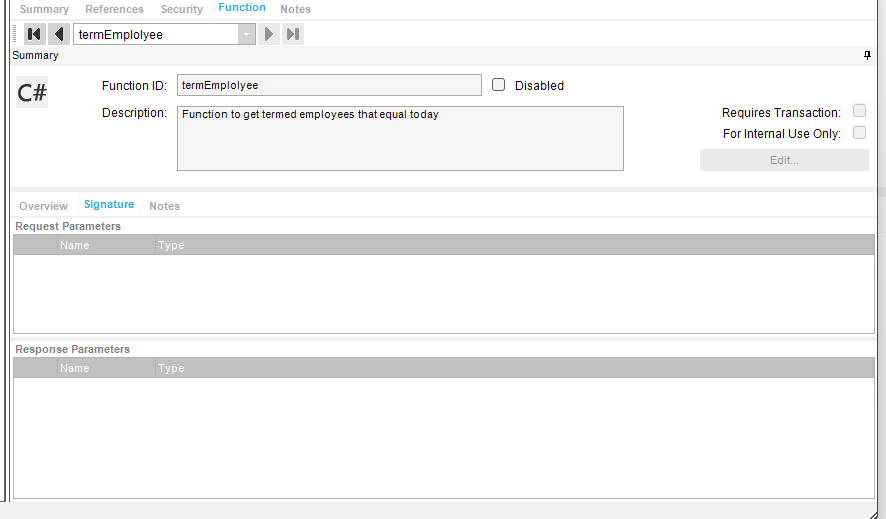

Can you share a screencap of the Invoke Function configuration? My first guess is that you’ve got the 2 response parameters this.output this.output2 in your function, and the BPM doesn’t know what to do with them.
sorry, I am running this from the schedule Epicor function.
Oh, that’s your problem right there. Remove both response parameters (temporarily). Schedule Epicor Function does not like response parameters.
Edit: Or create a separate function in the same library that calls the function you’re trying to test, and call that one with Schedule Epicor Function.
I’ve not had any problems?
I did make that change, removed all outputs and commented the code to remove them. Getting the same error. The error is very vague to me.
Generally, this means that a field does not have a value (null reference). Are you sure that all input parameters have values when calling the function?
I do not have any parameters for the function (as seen below), I am not calling a BO. I am going to put null ref checks for all the data I am getting from the Dayforce API call and see if some of those are null.
forgot to attach the photo
Have you tried testing your function first without wiring it up to Dayforce? Many here use Postman but you can use any API testing tool. Once you know that works, then you can test the Dayforce API. Once comfortable, you can then wire the two together.
