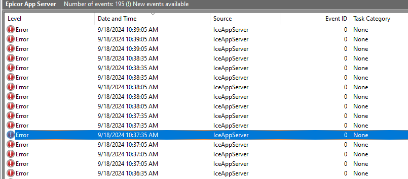

I’m getting hundreds of Invalid session errors in my event viewer. They all look like this:
Ice.Common.InvalidSessionException: Session with SessionID = c2ff600a-18f3-4e8c-950f-8e8c43845c79 is invalid. Session has either timed out or has been deleted. You must login again to continue.
No users have reported any issues. There seem to be 3 Session ID guids that are repeating. I’ve looked at all of the servers, and no sessions have any of the the 3 guids I keep seeing. Not that they would, or they’d be valid sessions, I guess.

Any thoughts on what might be causing this and / or how to stop it? Or maybe how to see the username associated with these Sessions? It’s ongoing, as there have been several dozen in the 3 minutes it took me to write this post.
